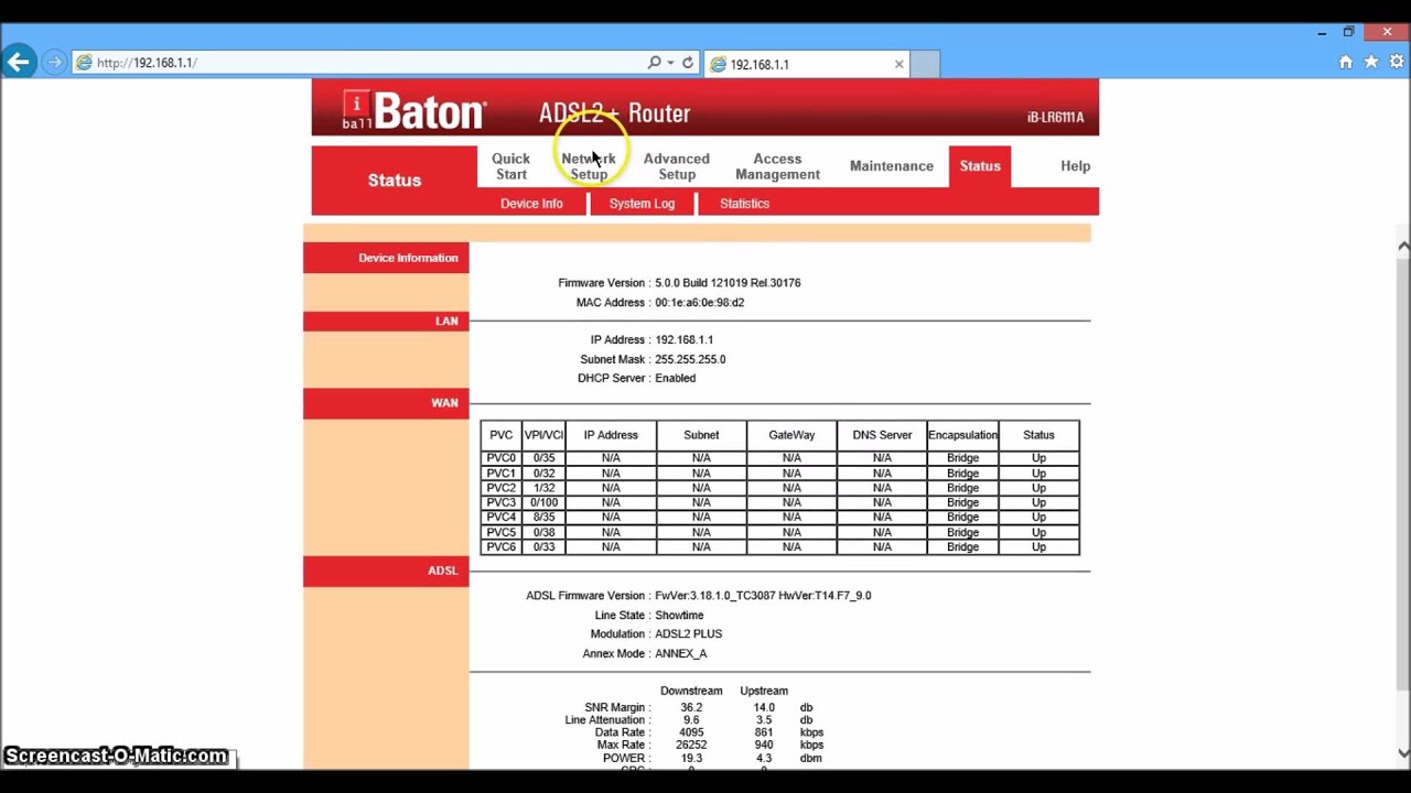

Had this happen with my MTNL Connection. Try going into https://selfcare.bsnl.co.in/tungsten/ ,.....Oh wait its under maintenance. When it comes back up check whether your connection is "active". If not call your local lineman. Maybe it is that your line is too noisy, go to your modem/.router page ie 192.168.1.1 and type in default login(admin, admin)
Send a pic of this page and make sure SNR is above 20dB for downsteam and line attenuation is below 40-50dB. If not then call your local lineman as your DSL/Phone line is too noisy
