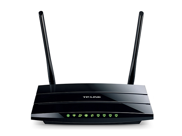

Hey, I have an Airtel ADSL 16 MBPS Broadband. It was working pretty fine before.
Nowadays if I restart the modem, it does connect the DSL Light but Internet light doesn't come.
I have to wait for luck or restart few times to have the third light.
Special Note: Third light doesn't blink. It's totally out/off.
What to do? What's wrong?
Modem: TD-W8970 300Mbps Wireless N Gigabit ADSL2+ Modem Router - TP-Link
@igloo @manojrk @Karan @wecaz @waterloo_sunset Please suggest!

Looks like modem is losing the sync. Have you tried it with a different modem?
@manojrk My Modem is TP-Link isn't it a good modem company? Just curious because it's costly.
I have had rewiring done yesterday direct from sub-pillar to home. (without any joint).
Current Setup:
Blue Box (Sub Pillar) ----> DP -----> Peach Box (to convert Wire into RJ 11 Jackable Port) ---> RJ 11 to Splitter -----> RJ 11 to Modem and RJ 11 to Landline.
I want to add that before 5-6 days ago, it was working very well. But just from last 5-6 days only, I am having this problem.
After rewiring, I have seen a very little improvement in parameters. Not significant.
It's very random again. I am not sure what's the matter.
I have tried using Huawei Modem which came with VDSL, I setup that as ADSL and checked the parameters, it's almost as same as my TP-Link's para only.
What do you say?
Not saying TP-Link's are bad. Yours might be faulty because it seems to lose the sync for unknown reasons. You should try with a spare modem for few days before concluding the line is at fault here.
