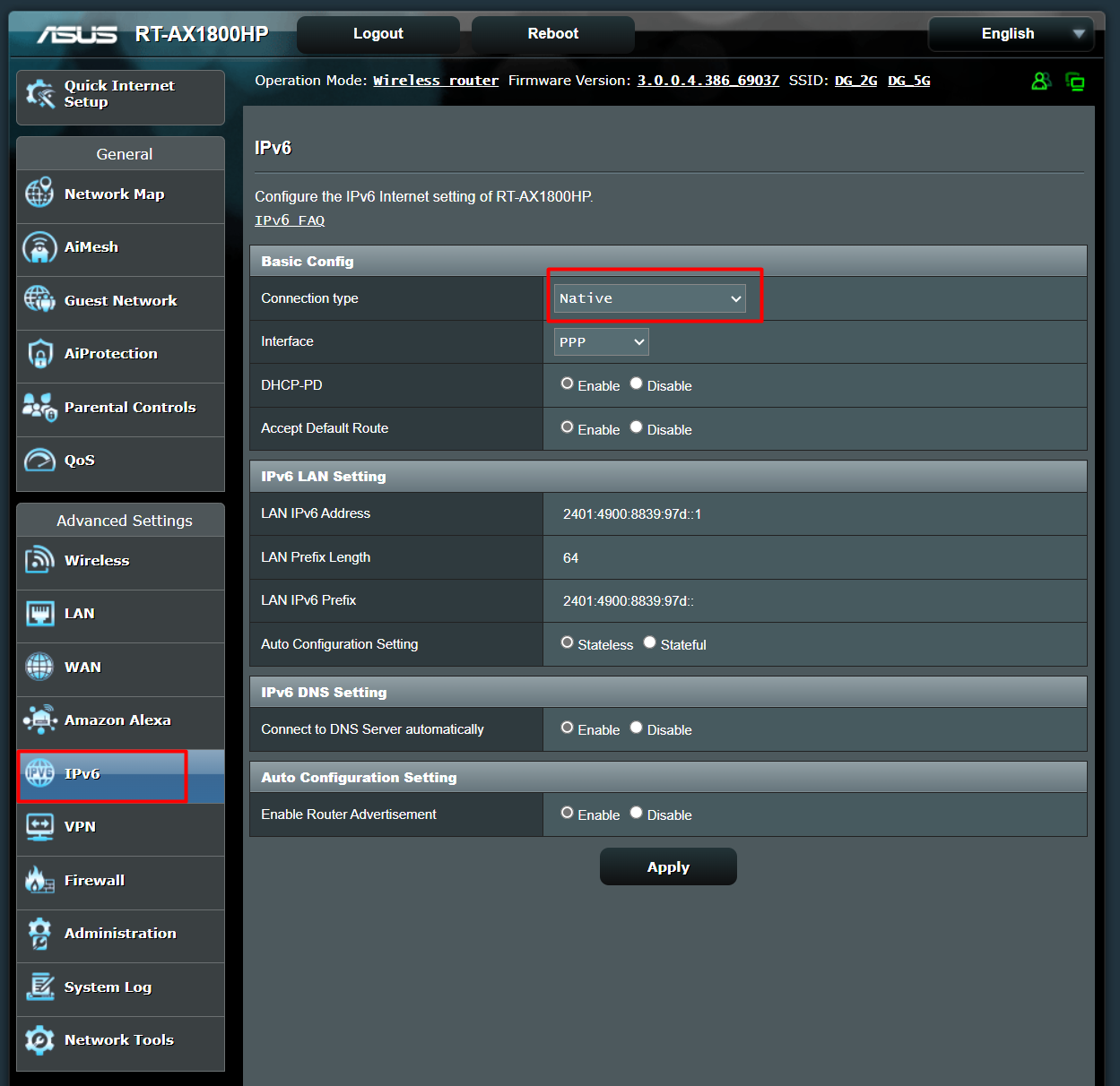

My Airtel broadband ONT is connected to Asus router via bridged mode (PPPoE dialing) IP is CGNAT.

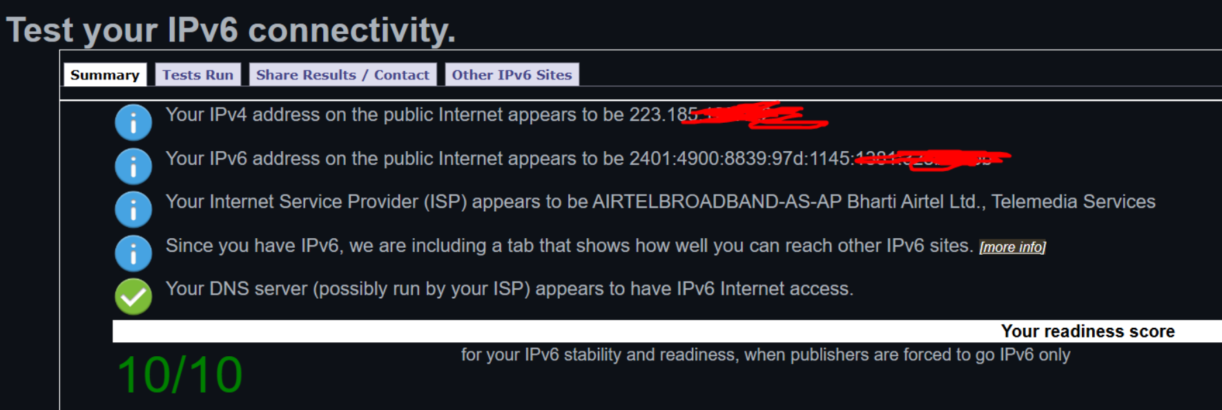

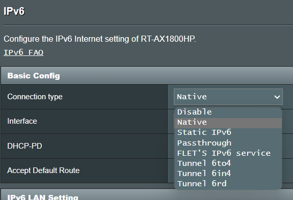

I tried enabling IPv6 via Asus router as seen in the below screenshot, from what I notice IPv6 gets activated, (even online IPv6 test shows it working) but the speed and connectivity is very inconsistent and slow, speed test shows just 10 mpbs once IPv6 is enabled and goes back to normal 200mbps once disabled.
what am I doing wrong ?
Few things you can try
1. Make sure NAT HW Acceleration is enabled.
2. Add IPv6 DNS from cloudflare or google
3. Check if there is any firmware update and then factory Reset your Asus Router and try setting it up as new.
yes NAT HW Acceleration is enabled
Added Google DNS and I could notice the speed was fine on few devices and other devices it was very slow and inconsistent; some devices report less than 5 mbps speed.
