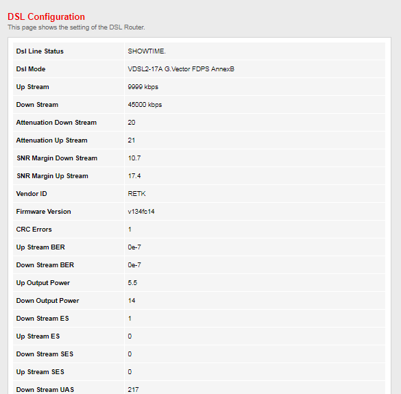

I am on 40 Mbps Connection (From Lucknow) and my speed keeps on Fluctuating during the day.Its only during the late night OR early morning I get 40+ Mbps speed..I have complained innumerable number of times.They have even changed my wires and got some sort of testing done but still no improvement.During the day speed keeps on fluctuating between 10-35 Mbps.It's very annoying.
Can anything be done regarding this.
Here are my stats:

@yougotmehere I'm aware that the line stats are not ideal but the only thing that's changed is the router. The connection was trouble free for 9 months with the Huawei.
Because Huawei has the best hardware chips among the three routers and it still can hold on steady till the last breath unlike others. I am not sure if those modems will ever come back as homemade (Binatone) routers are in circulation. Might wanna try bribing some service engineer to get you the Huawei one.
@raj2007 Check with your local service engineer as he can tell you in a sec. Usually they downscale the sync rates when their is some upgradation in the process or some kind of breakage or even a server glitch (My profile got corrupt at the server end and sync rates got randomly assigned)
