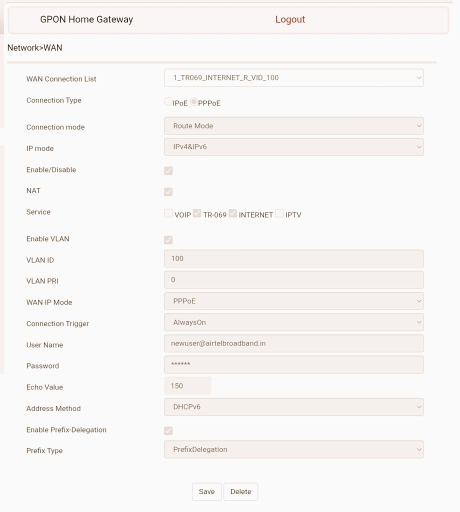

I have pressed the reset button 5-6 times and reseted the router , once you reset the router, we can access 192.168.1.1 admin panel, I have after putting all ports to bridge mode, we can not access the 192.168.1.1.
Problem is after putting all ports to Bridge mode or Even a selected PORT to bridge mode. Lan indicator goes OFF.
On Network > WAN, the it is showing Route Mode instead of Bridge Mode.
When I asked about this, the engineer said it's for static IP. For dynamic IP, Route mode will be showed.
He said only in case of PPoe connection, WAN Route mode will be shown. Don't know even if he anything or just bluffing

@Lolita_Magnum Yes bro. Thank you but the solution did not work. Please check this screenshot, After reseting the Airtel router, it is showing provisioning state (Zerotouch and username is newuser) the idiots at airtel are not willing to understand that they might have deleted my profile from my router. Is this Tha problem?
@Aashish.007 bhai .. connection mode BRIDGE rahegaa yaa Route , check the screenshot , it is still in Route Mode. Wan connection List mein ā€œRā€ he , does not it imply it is in Router mode ?
