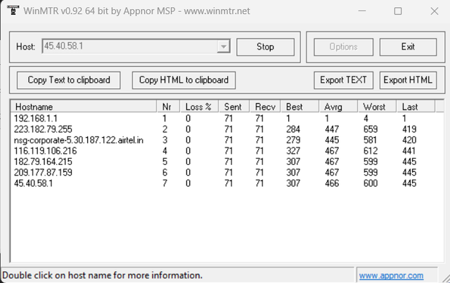

Other than the mentioned time frame, it works fine.
@JB701 I am on a wired connection. Also, you sure its a router issue ? I have had the exact same problem with the previous two routers(Huawei and Nokia).
no no, i meant Airtel's backend router as @Lolita_Magnum suggested. The first hop 192.168.1.1 is ur router, the ping increases at the second hop 223.182.79.255 which is Airtel's router located at their NOC.
Maybe its the congestion at peak times? Or some bug? Unlikely its overheating at night. Try showing Airtel the trace routes.

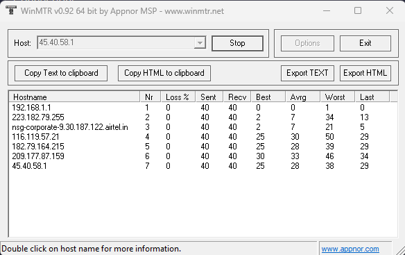

Yup I just did it, so it also falls under the timeslots you mentioned, plus I guess the city is also the same, based on both of our locations.
I am also on the 200 Mbps plan.
