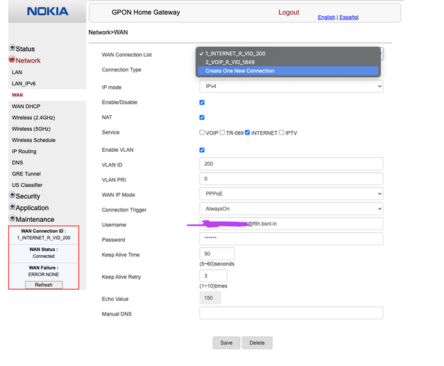

but please check i am not able to delete wan connection profiles or add any new profile! please help!
I want to use this with my local isp

That's wierd. It is enabled for me. But I had played with many toggles in the XML before I figured this out so maybe some setting that I changed is also contributing to unlocking the wan page. Maybe try searching for InterfaceConfig in the XML and setting enable to true everywhere and uploading the config back.
If that doesn't work, you can always manually add pppoe username and password under <WANPPPConnection.1. tag
can you please share your config using github or something? also please try creating a new wan connection list entry!
i tried it but i think it'll be best if you pass on your working config.cfg 😅
