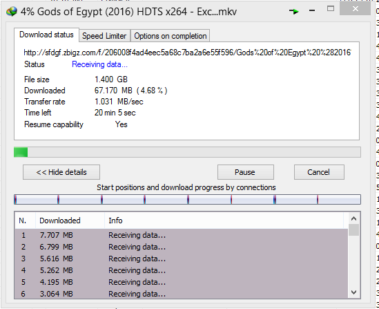

Now my average speed is around 6.7-6.9 mbps. Is it good?
I'm on 8Mbps plan too.
Download Speeds
you would see lots of members are stuck with 3mbps under 8mbps plan
Another reason for that is it is hard to find servers which support download at 8 Mbps. Most of the download servers set a lesser value to avoid spam attacks by unnecessary downloads of the file.
