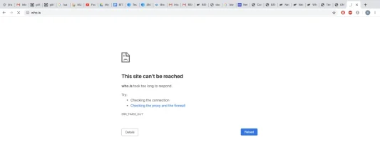

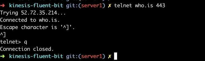

@varkey I changed nameservers to google DNS servers. But still no connectivity. Weird thing is name resolution is working fine and even telnet works. But when I access in browser, it is not loading. Also it is not like all the sites are not working. some works. For eg. google.com works even after connecting to VPN.
