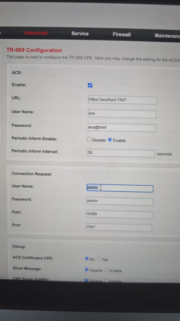

guys got bsnl installed as my backup connection
which onu should I get please suggest I tried it on vsol v280rh but the speed is stuck on 10mbps
LCO says its due to onu not syncing with acs servers so now looking for a simple onu that just converts the fiber to ethernet and I can dial pppoe in my router or any chances I could make the vsol work with bsnl

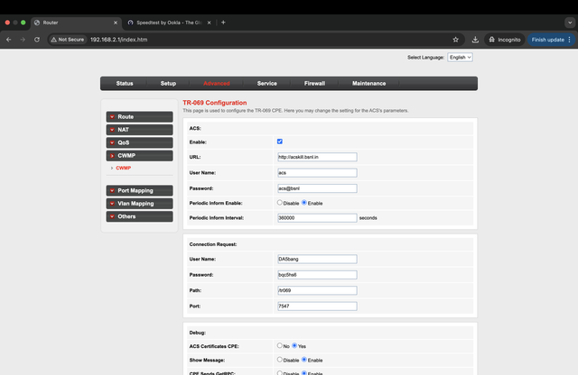

@sloj can you tell me the acs configuration
these are the settings I inserted in my vsol

@anmolbhard004 My connection is from before all these kinds of things were introduced. For now, I just have ONT authentication and no TR069. You can check on unofficial BSNL subreddit, there is a list of ONTs there.
