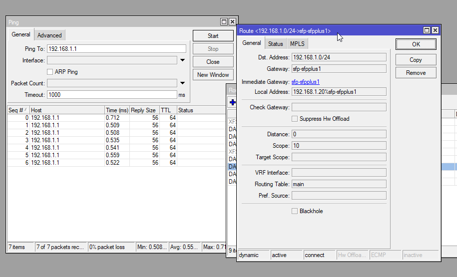

this correct ?/ my Mikrotik default ip is 192.168.1.1 and odi is 192.168.2.10
i dont think thats needed. In my case miktrotik has 192.168.88.1 and ODI has 192.168.1.1

  • Are you suggesting that once the fiber link comes up, the RB5009 can ping the SFP at 192.168.1.1? No configuration required?
  • How are the LAN clients (192.168.88.0/24) connecting to the web interface at 192.168.1.1 without a static route on the RB5009?

@hariselio My link issue was UPC vs APC, the SFP now shows a link and traffic, but I am still unable to ping 192.168.1.1
There is no route added in spite of re-adding 192.168.1.2 to the SFP interface.
@ishanjain28 Any ideas, the link is up now?
