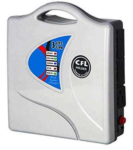

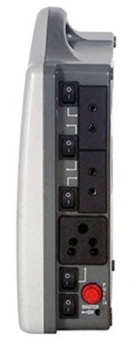

Get CFL inverter , you can easily get 3-4 hours back up on Modem with CFL inverter costing around 2k
