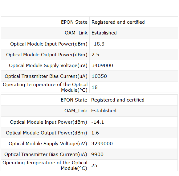

Now coming to my main purpose of this post. Since I live in Northern India, in the NCR region, the temperatures here during summers tend to cross 45C. I was skeptical about heating issues on the Syrotech ONT. Luckily, it has an inbuilt temperature monitor page, unlike my old Dlink. What I have noticed in my 4 days of usage is that the temp on this ONT goes up to 50C with normal usage and sometimes up to 60C under heavy load. This was a cause of concern for me. I know that the router can easily withstand such temps but running it hot for a longer term can affect its longetivity. It does come with a 3 year warranty but electronic components do not die outright unless a major malfunction but tend to age with time, extensive heating reduces their lifespan and performance. The maximum temp in my city is hovering around 40C, with ambient room temps at 30C without fan and AC. This will increase with time when outside temps go higher.

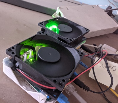

With this problem in mind, I looked for some solutions on the internet and I came across a post about cooling the router with a PC fan. I did a small DIY and managed to put together this contraption.
I use a 80mm fan from an old pc, I chipped off its connector and joined it with one end of a USB cable. This is a 12V fan, but I power it using a 5V charger which makes it run slow, hence no noise and vibrations.

After putting together this DIY I was unsure about where to keep the fan, and whether I should use it in a push config or a pull config. The Syrotech ONT that I have has vents only on the upper side.
Initially I thought about putting the fan over these vents to push/pull air. But there is a possibility of dust accumulation. However, just to test the efficiency of this setup I put the fan over the ONT and ran it for 10mins each, once in pull and once in push config.
Here are my obervations at ambient temps (30C approx) with no aircon on for 10 min:
Temps under load with no fan: 50C With Aircon: 43C
Temp under load, with fan in pull config: 29C With Aircon: 25C
Temp under load, with fan in push config: 24C With Aircon: 18C
I was however bothered with the dust accumulation inside the ONT, so this setup is not feasible for longer duration unless the fan has a dust filter, even with a dust filter the best config is the push one as air is pushed into the ONT and again pushed out throught the other vents. Since, I dont have a dust filter handy and I cannot get one due to the lockdown, I changed the position of the fan. Instead of blowing air into the vents, I put the fan besides the router and blow air across the ONT, not over the vents but over the solid part. The airlfow is also half because half of the fan remains hidden besides the router.
Temps with this setup hover at 27C with load and no aircon, and 21C with load and aircon. The AC temp is set at 22C. I am now happy with the overall results. I haven't monitored changes in performance and range and will report about it later. Also, do note that the fan I am using is from a PC that is 12 years old, its a non branded Chinese unit, I was surprised to see that it even works. I am sure newer fans, even cheap ones bought from computer shops will be highly efficient and branded ones from something like Coolermaster can surely freeze cool your ONTs. It might be worthwhile to invest in one if you own a expensive router.
