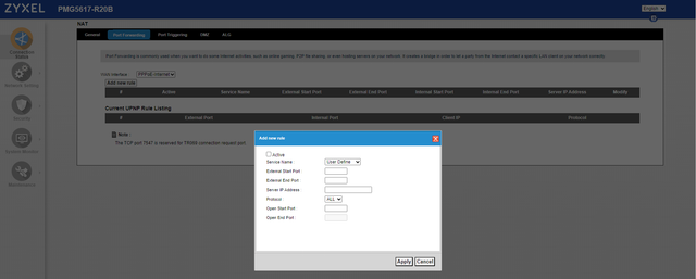

Firstly, I am trying to access plex media server as it is the simplest. The NAS server is assigned the private IP address 192.168.1.50 I can access plex from within the network at 192.168.1.50:32400/web/ I have enable port forwarding as per below given screenshot. For trying to access the server over the internet, I fetch my public IP from whatismyip.com and connect to [insert my public IP here]:32400/web/
Please find below screenshot of plex settings wherein I have specified public port 32400 to route to the private port 32400.

Your WAN Port under the Port-Forwarding config will be 32400-32400.
Go to your router's internet page → status → WAN → check the IP received.
If it's in anything different from the Public IP 122.162 that you see in your Plex (e.g. 100.68...). Then you will need to get a static IP.

Thanks for the revert, my IP is starting with 100.111. Just to clarify if I am looking at the correct place, please find below screenshot. I guess I am behind a CGNAT?

Your configuration is wrong. Protocol should be TCP. WAN Port should be the 32400 : 32400. Using 1 - 65535 is very unsafe because your are opening all the ports to your NAS. Better way of doing this would be to set DMZ if you want all the ports to be open to your NAS. You can use canyouseeme(dot)org to check if your port is accessible from the internet. And there is no need for Static IP since Plex uses its own Dynamic DNS to resolve server addresses.
