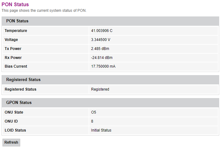

Also what's your Rx power? Did he use proper splicing with JC?

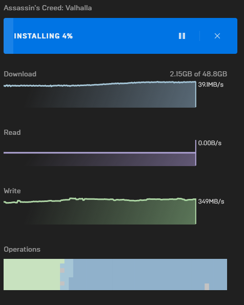

Also can you check download speeds on Epic game store?

@havoc steam img added. and there's nothing really worth the notice in the ONU. It's pretty standard.
pon information
no proper splicing, the usual stick method.
