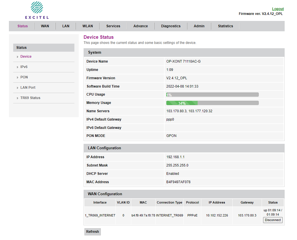

So, what is it hardware-wise?
The model is - 'OP-XONT 71110AC-G' a Standard AC1200 dual 2 GIGA PORT with EXCITEL custom firmware having an additional 'www.excitel.com' SSID broadcasting, which was possible to be disabled.
There's not much to config in the device itself, hence I just made the required adjustments and moved on to testing.

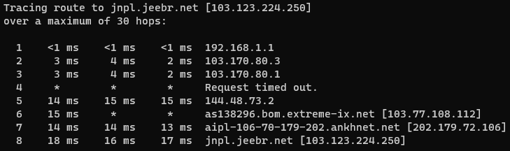

It's a standard CG-NAT-based connection over PPPoE with no IPV6. 100% of the international routes are through TATA AS4755 with an avg of ~3ms to the nearest transit center.
And for domestic routes and such routes like the nearest Internet Exchange or even google.com is through excitel's internal route which has an overhead of 18ms.

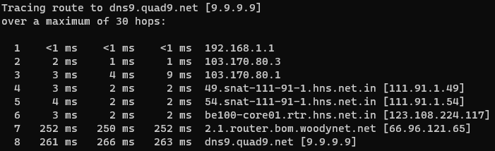

There also seem to be some routes through HonestyNetSolutions, eg 9.9.9.9.

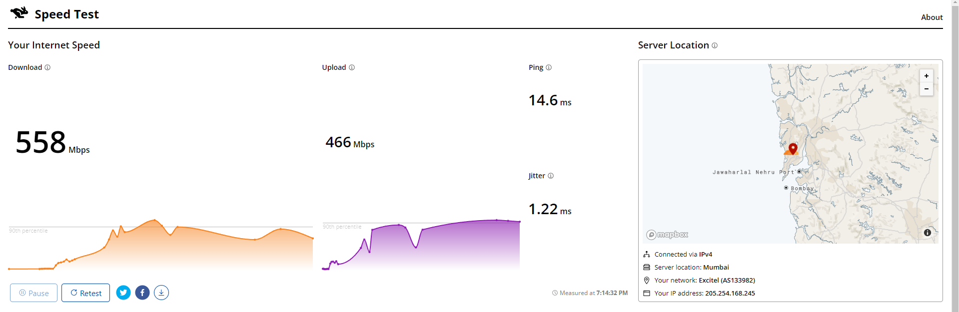

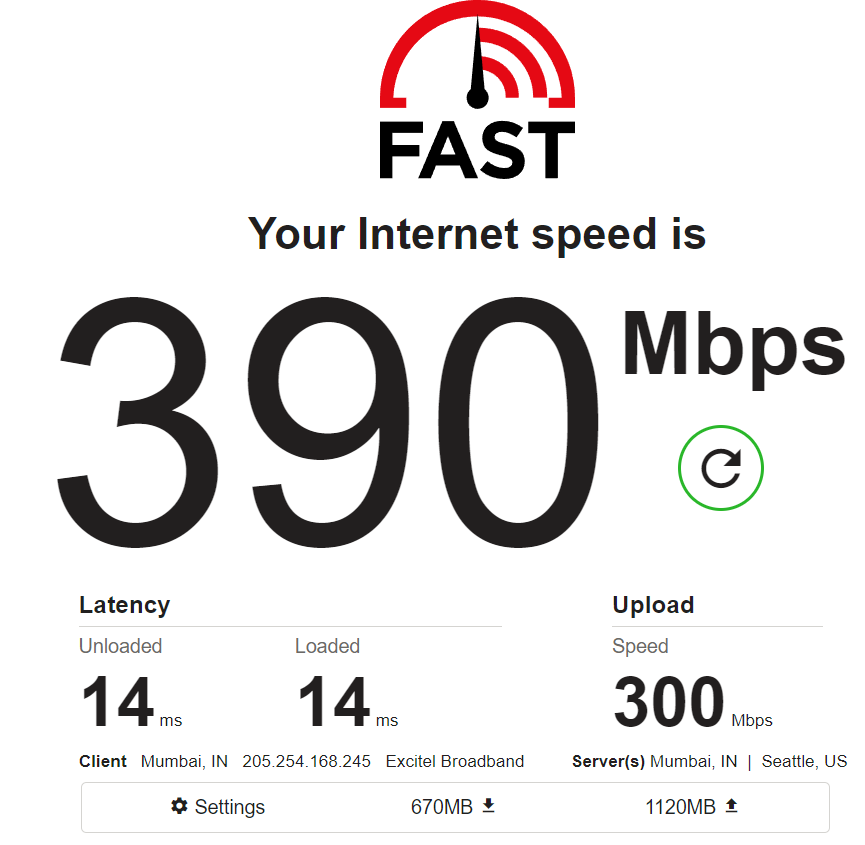

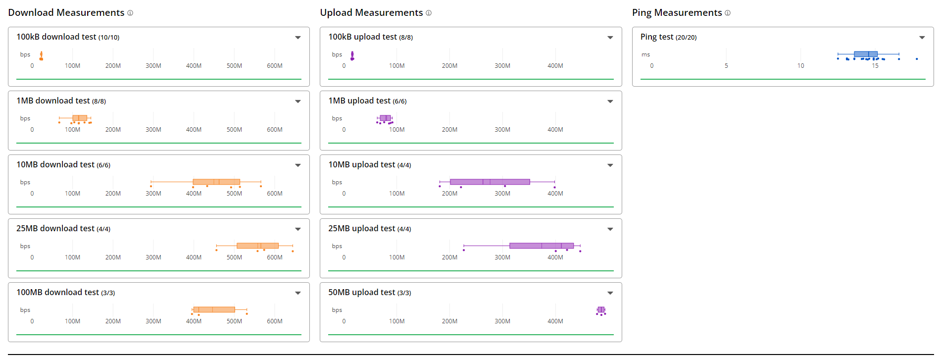

Speedtest...Speedtest.....SPEEDTESTS!!
You be the judge. Multi-Connections.
Domestic
International (Europe)
International (Tokyo)
International (US)
Single-Connections.
Domestic
International (US)
It's possible due to low customers, there is better than normal single connection performance and this will definitely depreciate with time.

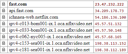

Faaaaasst.com (aka. Netflix)
Netflix oca being used ->

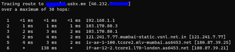

Some Traceroutes. (Since it's all Tata-based I won't add a lot, but if there is something you would like to see do comment below.)
tracert steampipe.akamaized.net
Tracing route to a1507.dscw27.akamai.net [144.48.73.72]
over a maximum of 30 hops:
1 <1 ms <1 ms <1 ms 192.168.1.1
2 2 ms 2 ms 2 ms 103.170.80.3
3 58 ms 36 ms 3 ms 103.170.80.1
4 16 ms * 15 ms 103.170.80.38
5 15 ms 14 ms 14 ms 144.48.73.72
Tracing route to static.88.99.202.116.clients.your-server.de [116.202.99.88]
2 2 ms 2 ms 1 ms 103.170.80.3
3 3 ms 2 ms 2 ms 103.170.80.1
4 3 ms 2 ms 2 ms 121.241.7.77.mumbai-static.vsnl.net.in [121.241.7.77]
5 4 ms 3 ms 3 ms ix-ae-1-100.tcore2.mlv-mumbai.as6453.net [180.87.39.25]
6 128 ms 127 ms 127 ms if-ae-2-2.tcore1.mlv-mumbai.as6453.net [180.87.38.1]
7 123 ms 123 ms 123 ms if-ae-5-2.tcore1.wyn-marseille.as6453.net [80.231.217.29]
8 128 ms 128 ms 127 ms if-ae-2-3.tcore2.wyn-marseille.as6453.net [80.231.217.51]
9 * * * Request timed out.
10 126 ms 125 ms 126 ms if-ae-50-2.tcore2.fnm-frankfurt.as6453.net [195.219.87.214]
11 125 ms * * if-ae-4-2.tcore1.fr0-frankfurt.as6453.net [195.219.87.18]
12 127 ms 125 ms 125 ms static.88.99.202.116.clients.your-server.de [116.202.99.88]

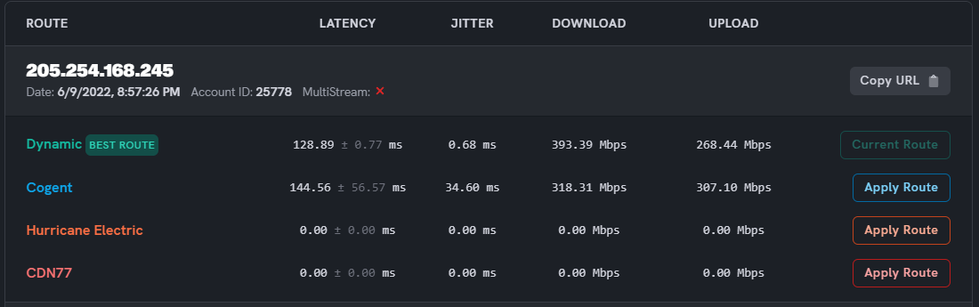

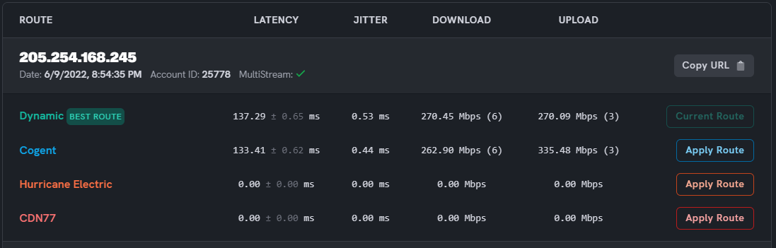

Speed.cloudflare.com
Ultra.cc - (seedbox)
Routes through CDN77 and HE did not work!

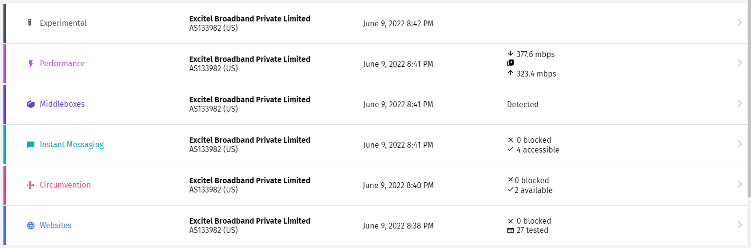

Website-Blocking?
It's a hit or miss, ie the usual DPI-based blocking hence you are better off using GoodbyeDPI.
The same goes for trackers.
OONI-Probe

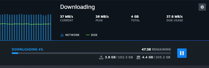

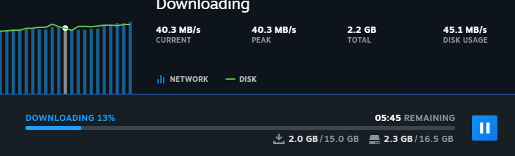

Steam-Downloads (Steam Cache was reset before download)
Steam puts me on DELHI servers, it also seems that most IP lookup tools think that I'm from Delhi.
I manually, reset it to Mumbai.
Game-1. (popular-game [prone to be cached])
Game-2. (rare-game)
The server is being used.

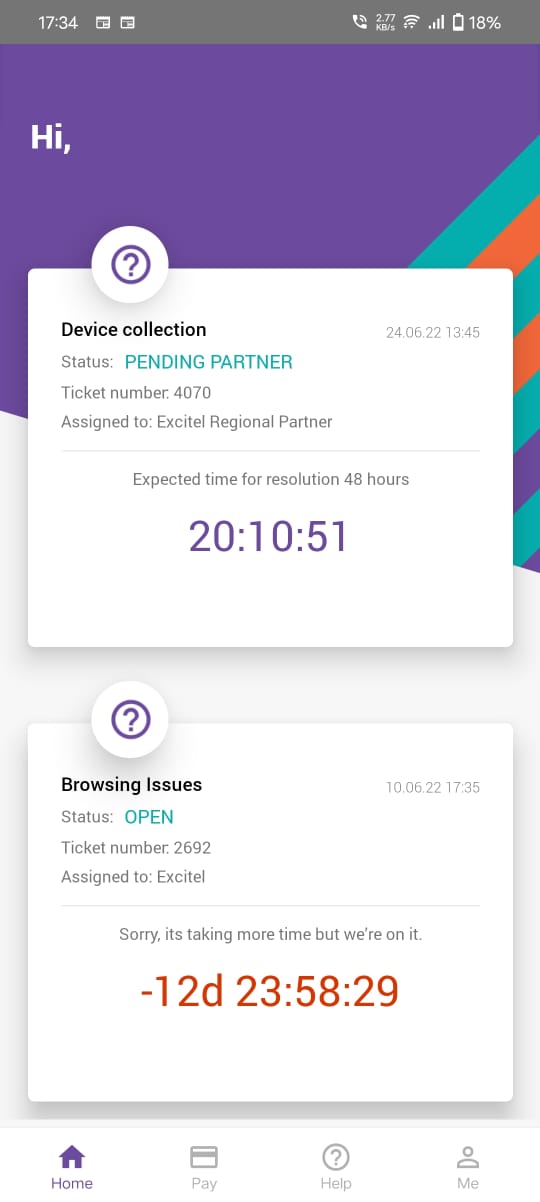

While the speeds are there, this is not what I would call quality. Excitel has asked for a 2000INR deposit for the ONU and a trail INR 590 for the first 3 months. aka 300Mbps.
Excitel also seems to have an SLA of 1 day for a 4h+ disconnection.

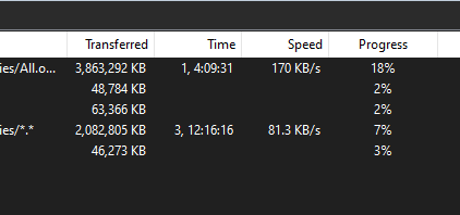

Man, they've messed up their CC by dividing zones... Previously it was all managed by New Delhi. Now who know who's doing what...
What is it that your are transferring though? I might need to look out for that aswell if anything important.
Excitel speed outside peering network is worst and same goes with torrents, u can download but upload is zero. If u have any specific use case scenario, better stay away from excitel. Its good for normal browsing, youtube and otts only, which is the use case for majority users. Once u have their connection nothing much u can do for rectifying technical issues, coz their customer care is even more worst.
In the image above is FTPse. But the issue is persistent for everything as @opomiyulen mentioned except peering everything is bad can't even happily download a game off steam without getting hiccups plus there's the dns poisoning and hijacking.
