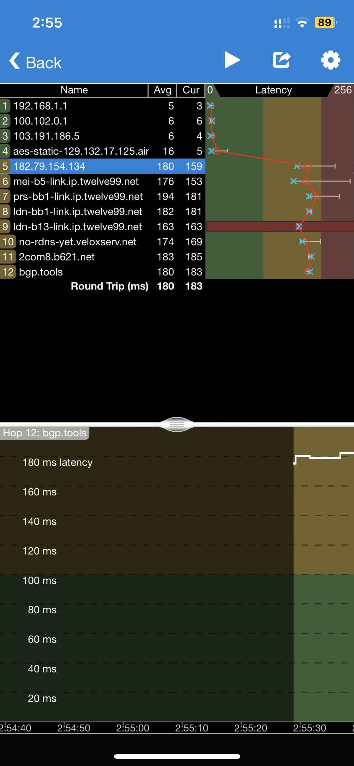

I’m From Kerala. Currently I’m using Airtel 5G/4G services & also using Asianet Broadband (AS17465) it’s primary upstream is Airtel (AS9498) so almost everything international surfing will route via Airtel.
The issue is that while I’m traceroute or the time required to open an international website ex: bgp.tools is 300+ms every time in both the broadband and in the Airtel 5G .
While tracerouting I found that a IP address 182.79.247.0/24 prefix is suspect/causing the routing issue .
It’s weird that the IP address is location is Chennai . Normally pings from Kerala ~ Chennai is 14-30ms. But this 182.79.247.0/24 IP address prefix is 160-200+. This issue is also in Airtel 5G/4G .I tried experimenting in another Airtel Upstream Broadband Kerala Vision (AS138754) the same IP address/prefix is causing the weird routing issue.
Is there any way to report/improve this issue ? By contacting the Airtel ?
Traceroute Image:IMG-3934 hosted at ImgBB
I see that this was reported in Oct but since there are no replies here - It's worth discussing it further.
182.79.247.0/24 - is not visible in routing table anymore. Are you still having this issue? If yes, share the IPv4 address which you are getting or CGNATed behind and I can try looking into it's routing. From partial trace you shared earlier - it shows Zayo AS6461 in picture which is not expected. Please share latest IPs and it worth worth exploring on why that is happening.
Hi
I looked into the forward trace i.e Kerala Vision > bgp.tools as you shared. Forward seem fine. Latency is little higher. I suspect bad return path here. Please share your wan IPv4 so can try to find the return path here. Expected latency here should be around 140ms. Thus you are off by around 40ms.
The IP in middle is OK. It's not a routed IP on the global table (and that is normal). ISPs many times use IPs on their internal routers where the aggregate is not originated in BGP because it won't serve any purpose except attracting random scanning traffic, DDoS etc. The jump on hop5 in your trace is because of return. Likely IP is somewhere in the EU on a Airtel router.
