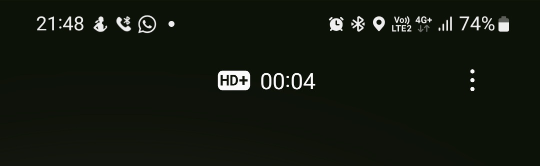

Anybody noticed the HD+ tag during calls on your Samsung Devices?
Apparently this only works if both recipients are using Samsung Devices and both user are using Vi.
I haven't tested on any other SIM.
There is definitely better clarity and quality compared to normal calls being it, "HD" or non HD.

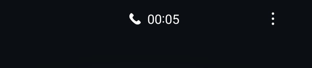

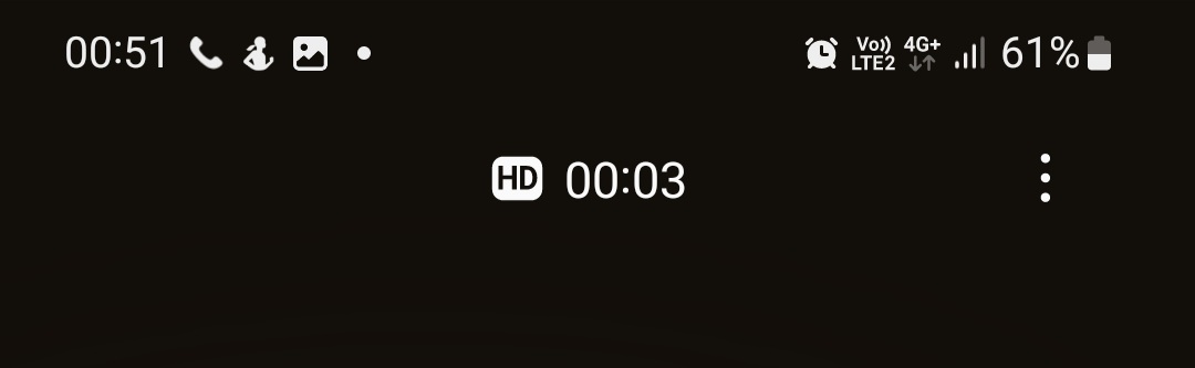

I guess you guys didn't get it.
Icon if you call a non Samsung number but is volte enabled. User is on Vi.
And here, if the receiving recipient does not have volte.
I think it's a samsung specific feature.
It works with same operator (Vi) & same brand phone (Samsung) with both parties.
Pretty cool in my opinion.
But as carriers don't support inter VOLTE calls I highly doubt smartphone brands will support it 🤔
What? Inter-VoLTE, at least the standard HD is support between different carriers.
Found something on wiki.
In addition, many carriers and devices can use Enhanced Voice Services (EVS). This is a superwideband (50–14,000 Hz) or fullband (20–20,000 Hz) codec backwards-compatible with AMR-WB.[18] This codec is also known under the trademark HD Voice+, after GSMA's certification program.[19] GSMA has proposed to make EVS mandatory just like AMR-WB.[18] (Both the carrier and the two calling devices must be capable of using the codec for it to be used.)
Fraunhofer IIS has previously demonstrated an implementation of the AAC-ELD codec in VoLTE that they call "Full-HD Voice". It has not gained any standard status or real-world adoption.[20] They have since reused the term "Full-HD Voice" for EVS in fullband mode (HD+ is also used).[18]
