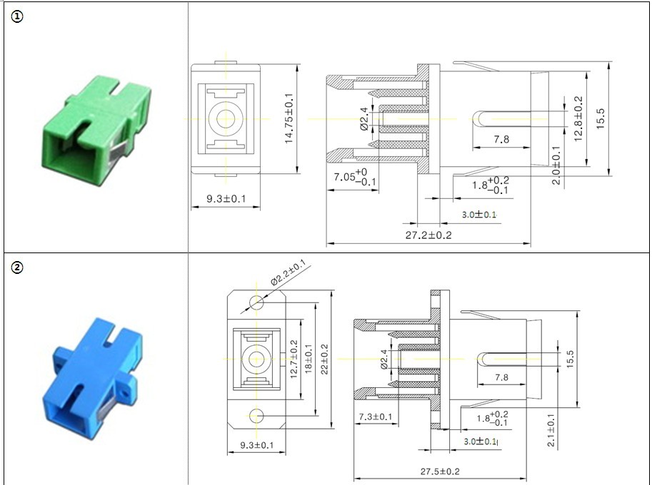

@abhishek.t thanks for the reply. I will check and purchase that. Currently, I have plugged the SC UPC patch cord into the XZ000-G7 SC APC port. Could that have damaged the XZ000-G7 port (inside the equipment)?
@RajaTamil no, damage is unlikely coz the connectors have some play in them. besides, the 'port' that you have in onts is simply a coupler (the one i mentioned earlier). there is a connector inside the device as well identical to the one we plug in, both get coupled at the port.
this is all you need @RajaTamil
the colour only serves the purpose of identifying what kind of connector is plugged in on the other end, let's say, inside a patch panel, coz ports are also just couplers. they are colour matched simply to avoid connector mismatch.
