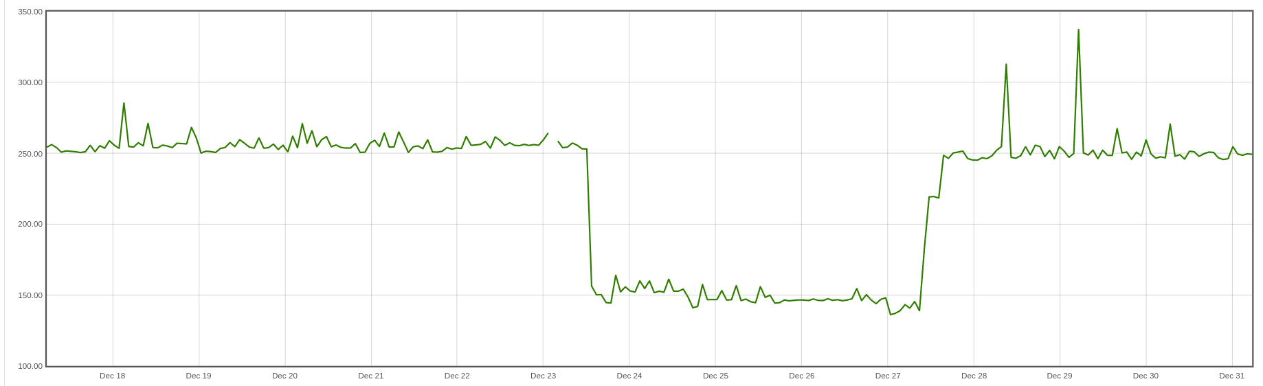

My latency graphs show that issue got fixed around noon time on Monday. Here's what average latency from EU to hundreds of Indian endpoints (behind a mix of Jio, Airtel, Tata Comm, Sify etc) looks like.
