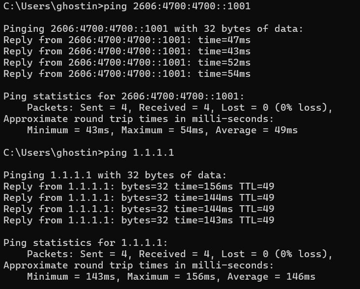

High Ping in IPV4 vs IPV6 is Jio air-fiber. I found that while connecting to an ipv6 server it has lower latency than the traditional ipv4. I thought it was temporary but I was wrong! It is prominent. I ran a ping test to one.one.one.one with both ipv4 and Ipv6 to prove my theory the results are in the image, As most of the game I played like Valorant use Ipv4 it is a big issue. Is there any we can fix that?
I think there some routing issues with Jio. For me ping to 1.1.1.1 stays at 70-80ms in the morning and goes upto 180ms in the evening. Ping to 1.0.0.1 remains low however
Try cloudflare wrap, it should improve the ping response
@ghostiin That's not native IPv4, that's 464XLAT. Means Public IPv6 to IPv4 conversion. The NAT64 DNS is handling the request and translating the IPv6 packets to IPv4. Jio's IPv4 latency is lower overall than IPv6. As you have AirFiber, it uses IPv6 as WAN Connection, that is why such results are showing up.
