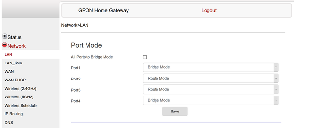

There is no need to contact Airtel CC for bridge mode. You can directly login to your ONT and change the port (where you have connected your Tenda router) mode to bridge.
Then log in to your router and config it for PPPoE with username and password.
Username is yourFullLandlineNumber[email protected]
and password is your account number which you can find on any one of the airtel pdf documents like installation report.
Also, you will have to set the VLAN for the internet as 100.
