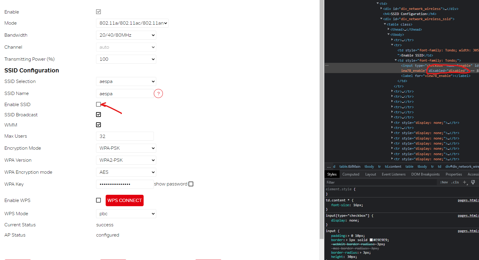

Just replaced ZTE ONT with sercomm as ZTE was lacking bridge mode. Now sercomm ONT is in bridge mode, connected to My router. How do I disable sercomm broadcasting ssids?
Okay.
For others who'd like to know, wifi disabling is greyed out by default. Just right-click on the checkbox, inspect the element, and remove the highlighted content.
The checkbox will be enabled, untick it and click save. Wifi should be disabled.
Same procedure to enable it back, or you can always hit reset.
