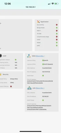

Does this mean i have activated the bridge mode on my ont?
