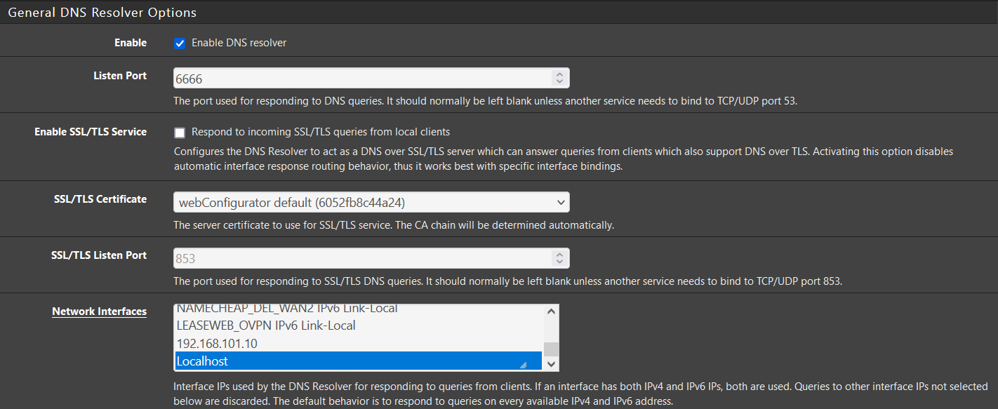

Step 1: Change the Port of your PFSense DNS Resolver​
Login to your PFSense Firewall web UI and go to Service> DNS Resolver and change the "Listen Port" from port 53 to some other port, I chose 6666. Set Network Interfaces to localhost, there is no need for the pfsense resolver to listen on LAN interface.

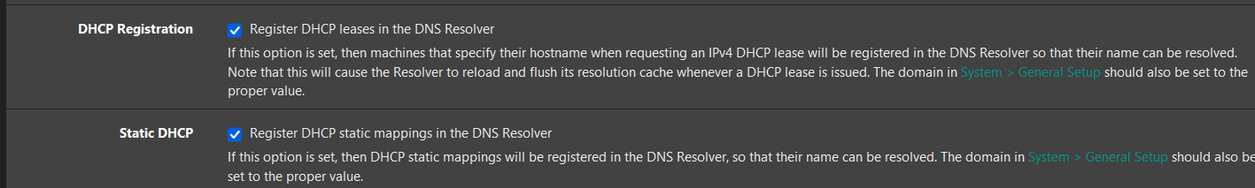

To enable rDNS lookups and hostname lookups for devices on your LAN, enable " DHCP Registration" and " Static DHCP" in DNS Resolver settings.

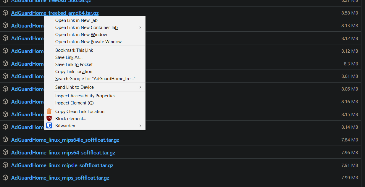

Step 2: Go to AdGuard home releases page and get the FreeBSD Version:​
Go to Releases · AdguardTeam/AdGuardHome
Then get the latest version of AdGuard for FreeBSD (as PFSense runs on FreeBSD). Most likely you will have 64Bit version of PFSense so you need AdGuardHome_freebsd_amd64.tar.gz . However if you have 32 Bit PFSense you need AdGuardHome_freebsd_386.tar.gz.
Step 3: SSH into your PFSense box​
Right click and copy the link of the release.

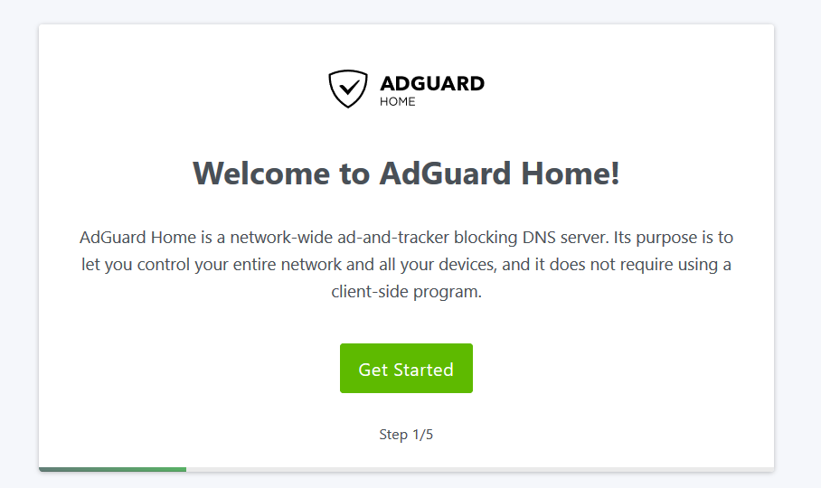

Go to your router URL with port 3000 on your browser. In my case its http://192.168.5.1:3000 . Replace 192.168.5.1 to your PFSense Address.
It should open the web interface of AdGuard Home.
Click on Get Started.

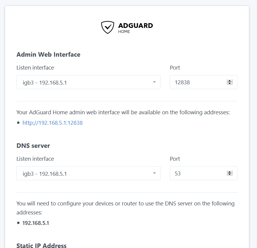

Now you will see a screen asking to setup interfaces for AdGuard UI and Resolver to run on. You need to set both the Admin Interface and DNS Server Interface to your LAN Interface. In my case it is igb3. It will also show the IP of the Interface next to it to help you identify easily. In my case it is 192.168.5.1 which is the IP Address of my router.
Set the same interface for DNS Server.
Also, make sure to change the Port of web interface from 80 to something that is unlikely to be used on the network. Lets say port 12838. Choose any high port that isn’t likely to conflict with your other applications.

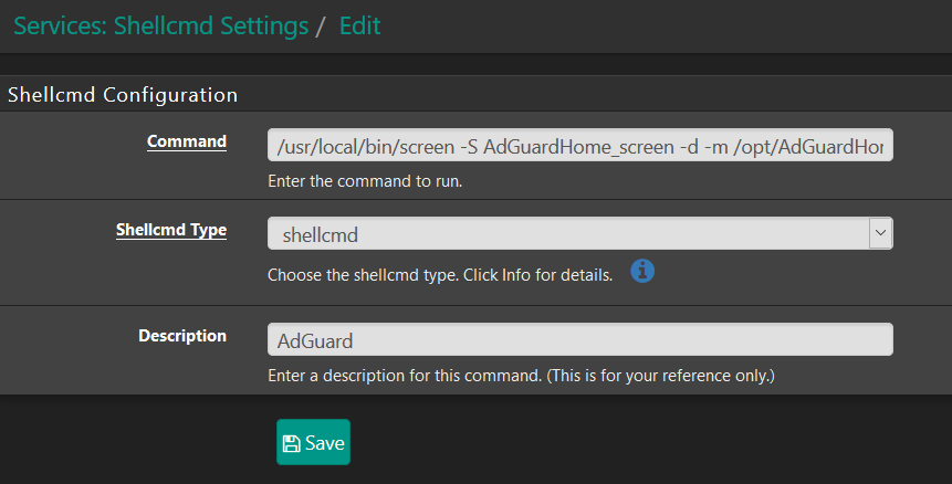

Step 6: Making AdGuard Home start on boot:​
Go to Services>shellcmd and click Add
Command: /usr/local/bin/screen -S AdGuardHome_screen -d -m /opt/AdGuardHome/AdGuardHome
Shellcmd Type: shellcmd
Description: AdGuard
Click Save
Reboot PFSense and AdGuardHome will start up.

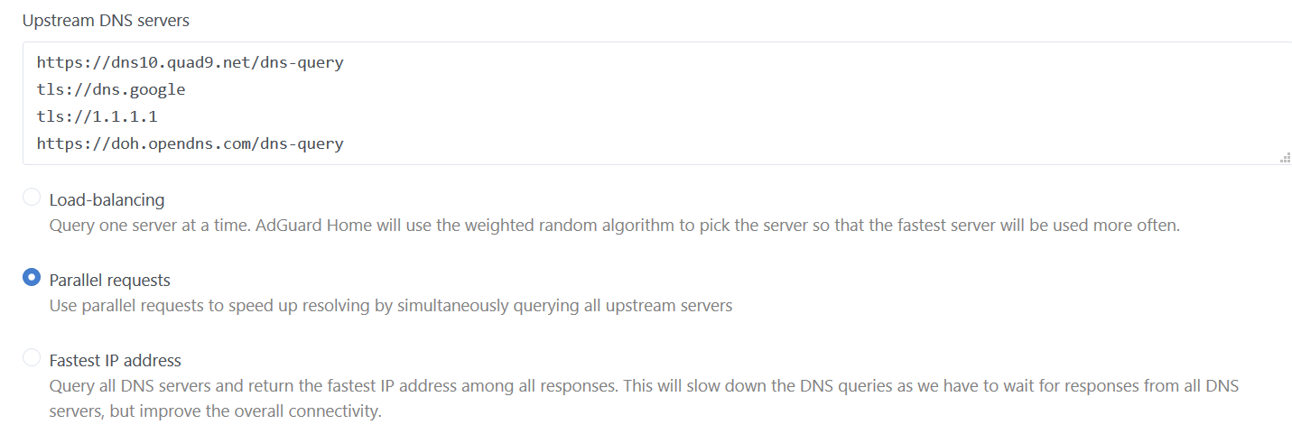

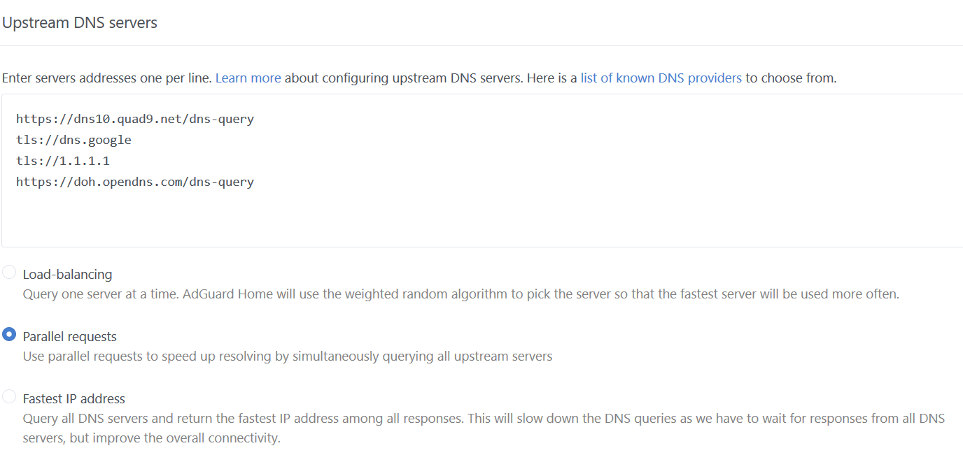

Use the upstream DNS Server of your choice. These are my resolvers
Code:
https://dns10.quad9.net/dns-query
tls://dns.google
tls://1.1.1.1
https://doh.opendns.com/dns-query
Find more Encrypted DNS Resolvers at DNS Privacy Public Resolvers - DNS Privacy Project - Global Site
Set the query mode to “Parralel Requests” for faster queries.

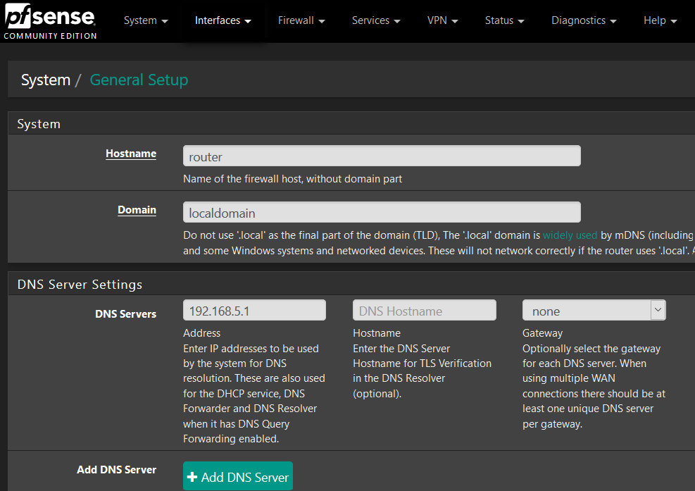

Step 8: Set PFSense to use the AdGuard DNS:​
Go to System> General Setup in PFSense Web Interface and set the DNS Server to 192.168.5.1 and remove any other resolvers.
