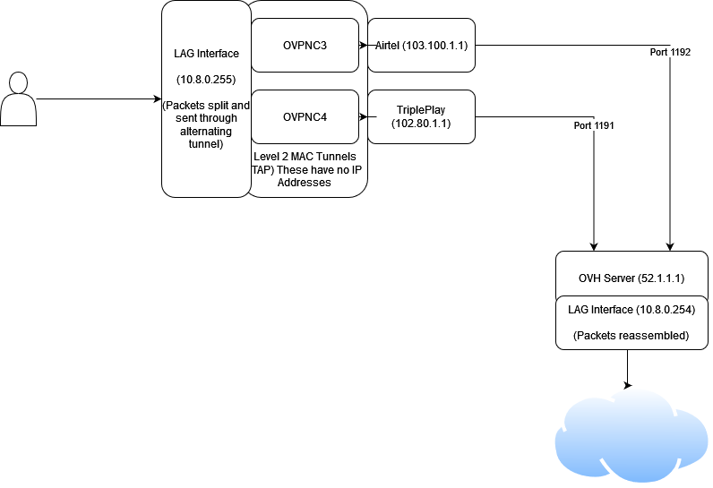

Just wanted to create a thread about bonding two networks together for faster speed.
Unlike Load balancing where one connection is routed over one gateway and next one through next etc, bonding takes each packet through alternating WANs to a common VPS on the internet, these packets are then reassembled by the VPS and sent as a single connection to the actual site you are connecting to so you get full speed even over a single connection.
Unlike load balancing where many connections (applications like torrents work well using load balancing as you are connecting to many peers all around the world) are needed to take proper advantage of the full bandwidth, bonding can work even on single connection transfers (eg. downloading a file on a browser).

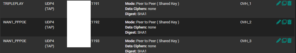

Then I added these 3 clients on my PFSense box at home:

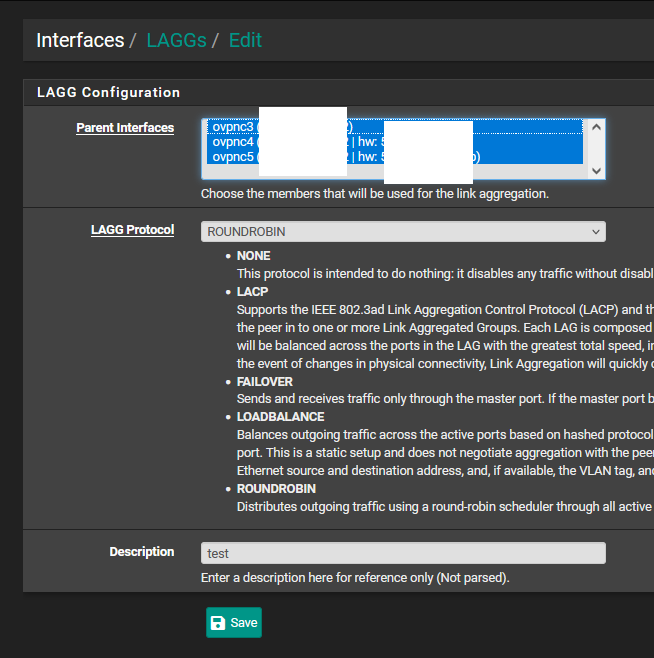

I created a LAGG (Link Aggregation) interface in PFSense and add the OVPN Clients to it:

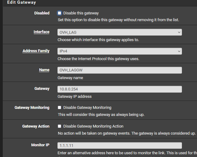

Created a gateway for the LAG Interface (which is the internal openvpn ip of the server):

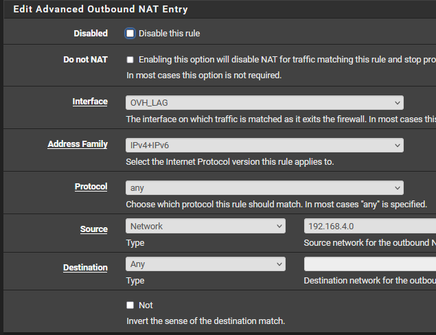

NAT Rules:

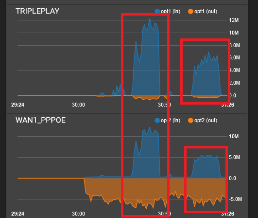

I used the single connection test to make sure it wasn't just load balancing the two connection and instead actually bonding it.
What I wanted to show was that the traffic was indeed flowing through both the ISPs despite the speedtest being on a single connection!:
Yes, the full capacity of my WANs aren't being utilized but I wanted to share this nonetheless.
NAT Rules:
