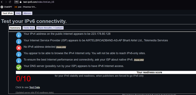

Hello guys, i need help on getting my network ipv6.
my onu is zte f670l. i use TP-Link AX1500 wi-fi6.
my pc is connected to TP link and have pi-hole connected to zte via lan .
when i test ipv6 on Ipv6 test i get 0/10.

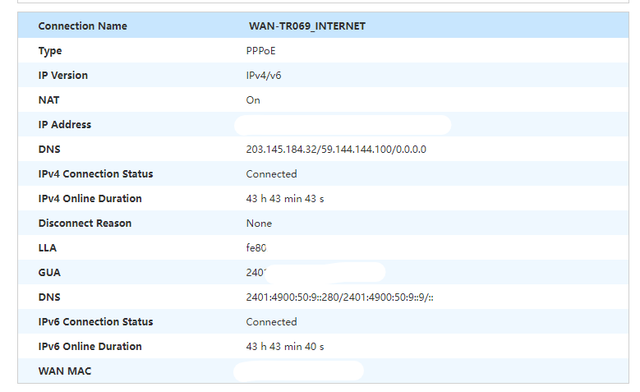

my zte
shows ip v6 available and in my tp-link if i set the ipv6 to pass-through bridge ipv6 test shows success and v6 is detected in whatismyip. but i am unable to use pi-hole to block/filter stuff. any way to use my pi-hole here?

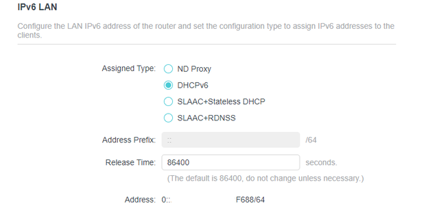

next question is if i set to DHCP6 or SLAAC then test website says i have ipv6 dns but says i dont have v6.

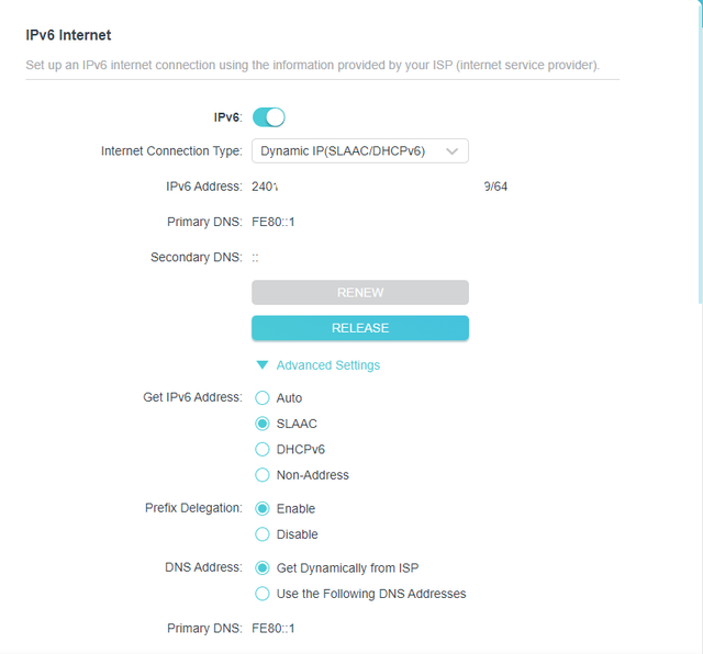

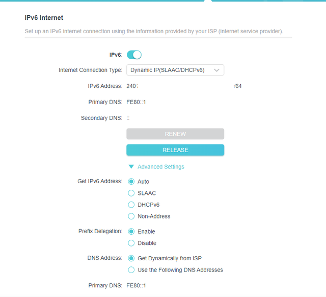

my router page for ipv6 internet (connectivity from ONU to TPlink)

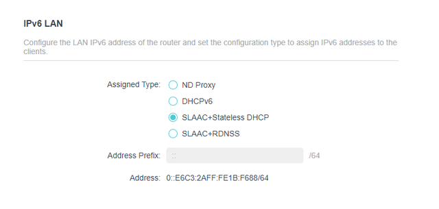

ipv6 for LAN setting from tplink to PC

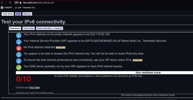

test website
If i set to SLAAC on ONU to router and router to PC
router setting ONU to TP-link
TPlink LAN setting
pc LAN settings
test website
i want to route all my DNS traffic of ipv6 from my pihole connected directly to onu. any help? any other information required?
