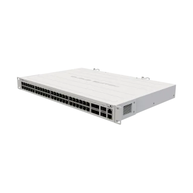

If you are looking for unmanaged then TP-Link will do fine:
Mikrotik makes affordable managed switches
