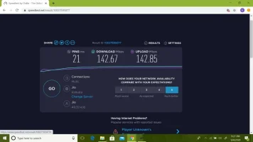

On 100mbps plan and 5ghz.
Upvote 0

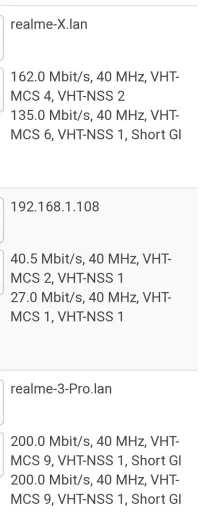

How to find this in phone?
For android, go to wifi settings, then touch the wheel icon on the right side of the connected network. Your band should be visible there.
The last line in the settings also mentions your link rate to the router. Your speeds will depend on that too.

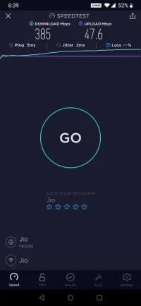

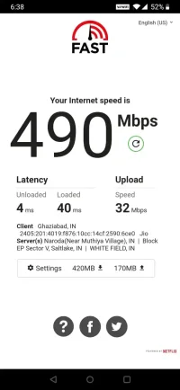

On mobile (OP6T): check attached images.
