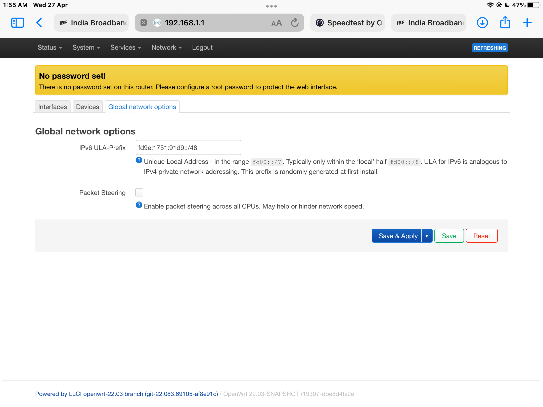

I think by default packet steering is not enabled on OpenWRT. Had you enabled it manually?
I don't know but something very strange Is working out for me. I was having same problem with c6 V3 but when I put the router a bit far from walls and other stuff it started giving me again speeds of 300+ Mbps constantly. Try moving Router away from things then reboot it and let me know it helps.
