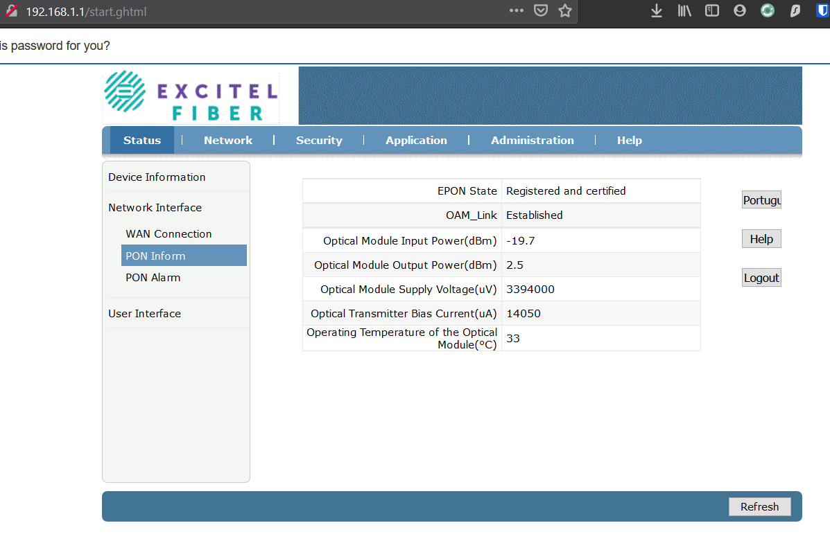

Figured out that one. The router IP isn't actually 192.168.10.1 its 192.168.1.1 . In the back and in manual its written 192.168.10.1. I think its changed by Excitel.

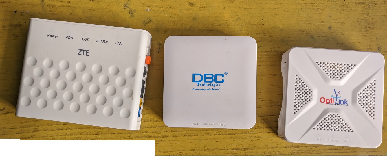

I have three ONTs now. The left ZTE one has the option to change Serial No. But even after changing the serial, it gets "Not Authorized" message for some reason. I think its because Excitel might also be using PON MAC Address which is mentioned on portal.

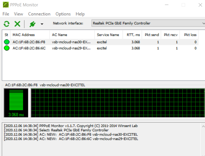

The second one, DBC for some reason Authenticates with OLT but PPPoE Servers don't show up or connect. I tried with PPPoE Scanner but servers aren't showing. This one doesn't have the option for Serial Spoofing unlike ZTE.
The third one is provided by Excitel. This one works ofc and PPPoE Servers work as expected. From the looks it seems to have same board as DBC one, the reason LED is brighter is because of the meshy housing probably.
The PPPoE servers are showing up as expected when connected to this directly.

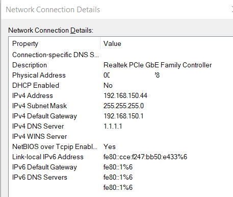

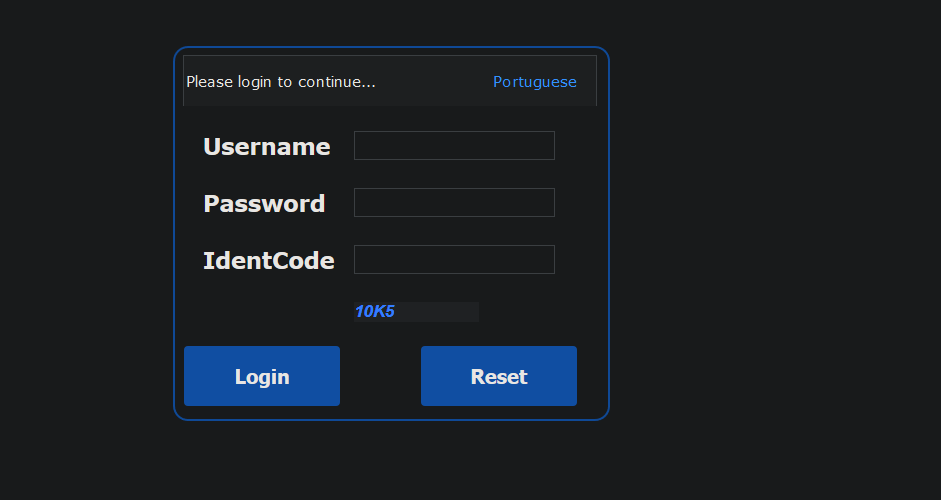

Originally this had IP 192.168.1.0/24 but I changed it to 192.168.150.1 to avoid conflict. When I connect to the ONT and assign static IP, the WebUI loads:
Interestingly on top right it says "Portuguese" instead of "中文" which is Chinese on most ONTs with similar UI.
