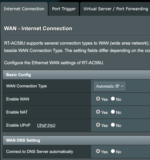

Hey Experts,
Need ur inputs and clarification regarding my current setup
My current Airtel BB connection (with static IP)
The above setup has been working fine for me, but I have been reading lot of comments on this forum about
  • ONT
  • Bridged mode
  • Dialing Static IP/PPPoE from my 2nd router (Asus)
So just wanted to understand is my current setup fine or I need to change connection to my mode via PPPoE mode...
I am confused please help...

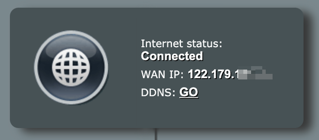

Thanks @Skeeter
I was able to setup my Asus router on Bridged mode via PPPoE protocol, it was a easy setup and now I can see my Airtel static IP when logged in to Asus router and internet works without any speed drop.
