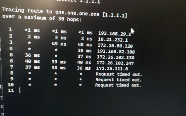

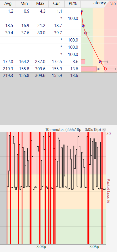

Since a few days, I have been randomly experiencing issues for a few seconds every now and then. The duration of these issues have been increasing. Some days (like yesterday) internet barely works (extreme packet loss, perfect speed in speed tests though) for 1-3 hrs and randomly stops working for a few seconds throughout the day.
Some websites are also randomly not working, or not working properly.
I noticed that the third node in traceroutes is always having problem.
Yesterday, it was in really bad condition:
One more thing though, a friend who lives like 300kms from here who had similar routes (and similar ping from 3rd node) have much better ping now. He is having 6ms on WiFi to the third node instead of the typical 15-20ms he had before. So, I wonder if they are working on improving things in Chhattisgarh or they are just giving priority to bigger cities.

I have been trying to get it noticed by Jio team but they kept telling to restart router or reset it. So, mailed it to Reliance CM office email and then they raised a service request. Their supposed-to-be engineer came at around 10 AM and did the honour of speed test, to tell me that my internet is perfectly fine. I told him that there is mainly browsing speed issue at random times throughout the day, which happens especially after noon, and it is definitely not local issue. He ignored it even after I shown him traceroute screenshots. As usual, he reset the router and then told me to turn it off before I sleep everyday and I won't have any issue. ^_^
They are coming again tomorrow, saying they will "definitely fix it".
I forgot to show how shit their IPv6 works but since they reset the router, I remembered the experience again. Will show their professional engineer this tomorrow.
