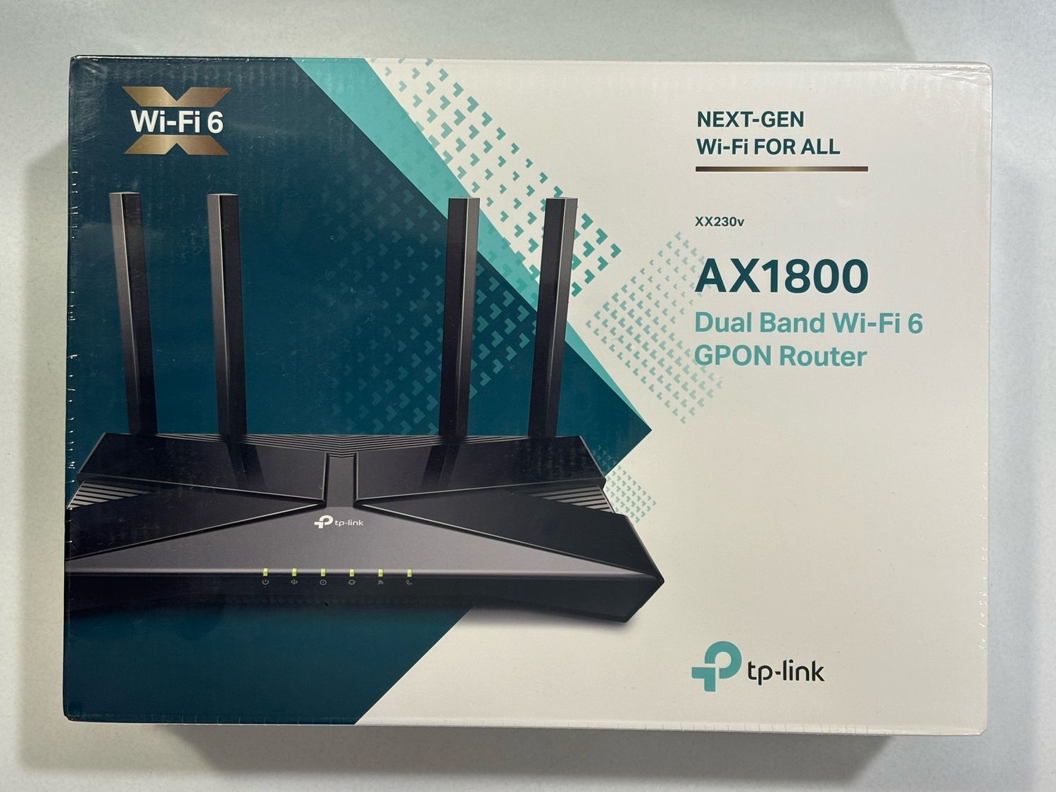

Get a TP-Link GPON router like xx230v or xc220 user id is your Airtel email and password is you customer id (on thank app or bill you can see) vlan is 100 and for voip it is 660.
Another option is get Deco old model will work fine pack of 3 for 8k and use them as main router and in Airtel router turn off 2.4ghz ( so that deco channel doesn't conflict with Airtel native router)
I have xx230v connect with re305. Extender as onemesh.
Never check voip mode, don't use it. But it is connect i guess.

In 1 year inhad two my Airtel router changed Nokia unit.
But nothing solved frequently wifi drop.
Can't say about TP-Link yet. It been just 4 days since im using,
After a month i can review.
My house is village and i have a very large home with very fat beam and double brick wall.
Only difference i have seen in past 4 days is that my servent room can receive 2 bar.
And in 2.4ghz i can get 150 my kids .
Extender is for my mini office - online work.
