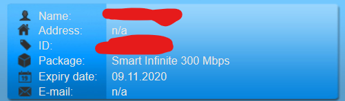

Plans sound pretty cheap. As I wanted a replacement for PNPL I decided to go with their 300Mbps plan costing 1800/month.

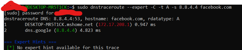

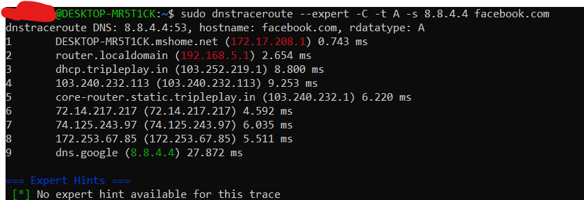

DNS Hijacking is present on Powernet atleast on Carrier Grade NAT. This can be shown using DNSTraceroute farrokhi/dnsdiag
As you can see the DNS Server is only one hop away which obviously isn’t possible. Compare this to my TriplePlay connection:
So, if you don’t want Powernet to intercept your queries, use Encrypted DNS!

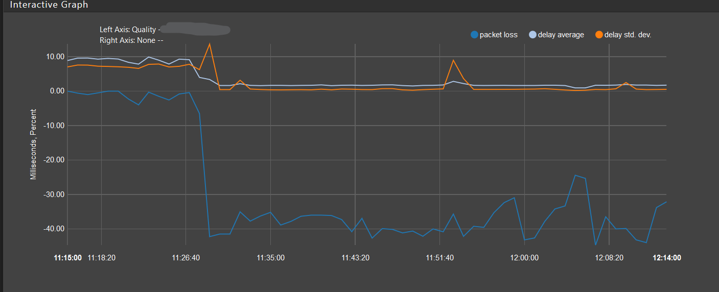

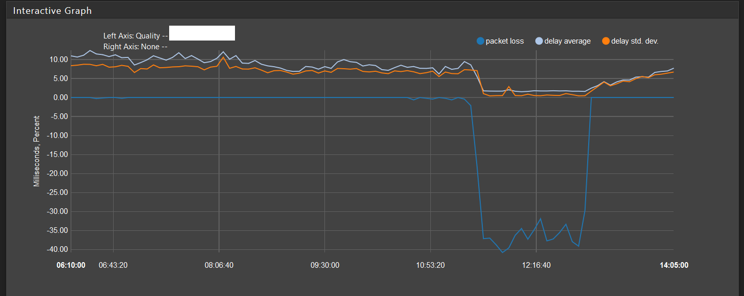

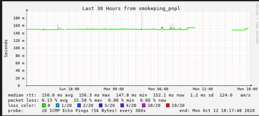

Powernet is very reliant on that TATA uplink. There isn’t any significant hourly packet loss I could detect from Smokeping.
Ignore the downtime, its because power went out too long.

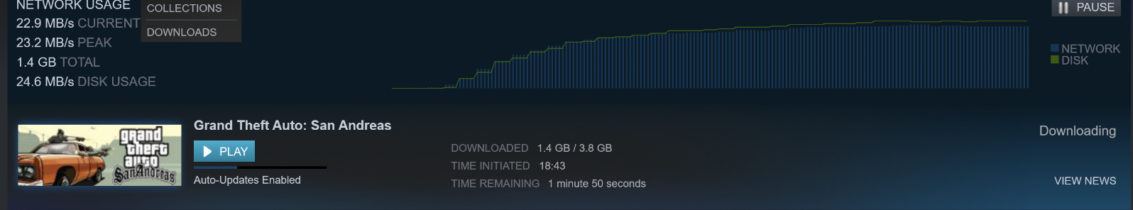

While Powernet is indeed better than my pile of shit PNPL connection in terms of international speeds. Its closer to 200Mbps on my 300Mbps plan. This makes 300Mbps Powernet plans hard to recommend. However, you will likely reach full speed on 100Mbps plans or below on international servers.
Steam reaches 23-24MB/s which is around 200Mbps.
