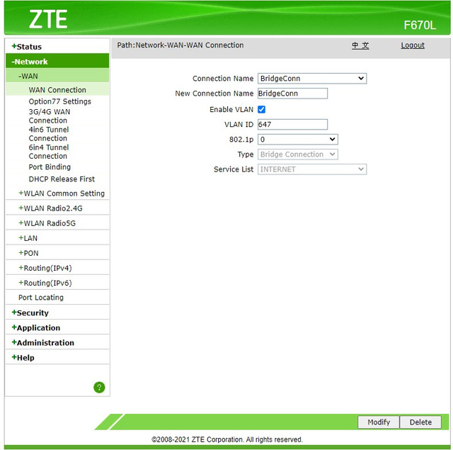

Step 1: Create a Bridge connection as shown below on your Hathway ZTE 670L router's WAN settings.
Step 2: Bind the above created connection to any LAN port ( I have binded it to LAN Port 4)

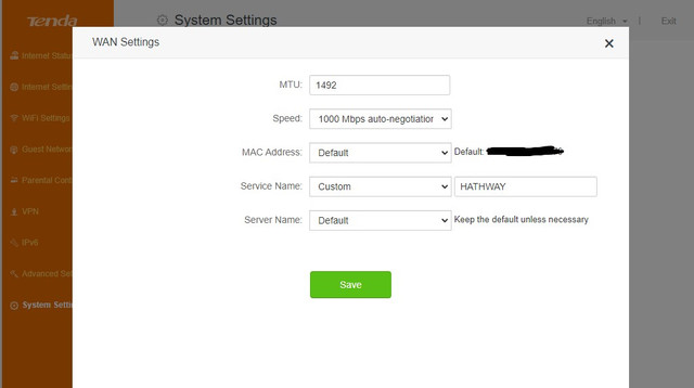

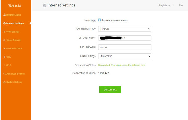

Step 4: This step is router specific , so update config according to your router. My current router is TendaAC10 . Setup PPPOE connection on router as below.
Step 5: (Optional) - Set the service Name field if required by your ISP. In my case Hathway requires service name to be set for PPPOE to work. For Hathway the service name should be exactly spelled "HATHWAY" .
