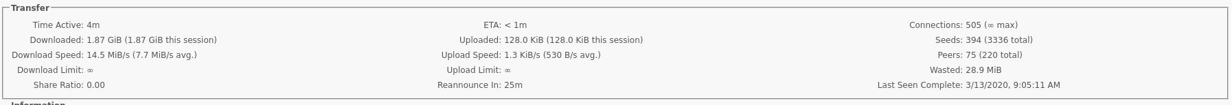

Torrents are kinda hard to measure but I did try Ubuntu ISO, it was able to get beyond 100Mbit (around ~15MB/s) but the problem is it only got to this speed half way through the download (you can see the 7.7MB/s avg). It was initally quite slow at 4-5MB/s and this is a torrent with tons of seeders.
Also, good luck getting any upload on private trackers as PNPL doesn't have either IPv6 or any option for Public IP (paid or otherwise), so you are mostly closed off from the internet.

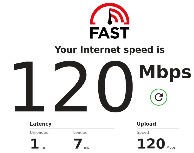

With US or EU servers its even lower like 30-40Mbit/s . Kinda expected speed to increase with static IP, its about the same. Granted this was during congestion time.
Without VPN
With VPN:
TriplePlay without VPN (100Mbit Plan)
