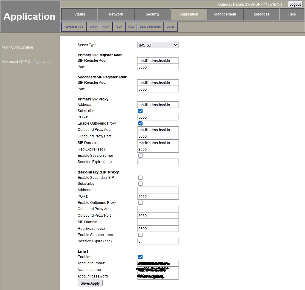

I have disabled the Wi-Fi, and am using the device purely as a Modem. There is a POTS device connected to the Combo device, and it is currently working (Make and Recieve Calls). I need to keep the Phone Line connected and operational.

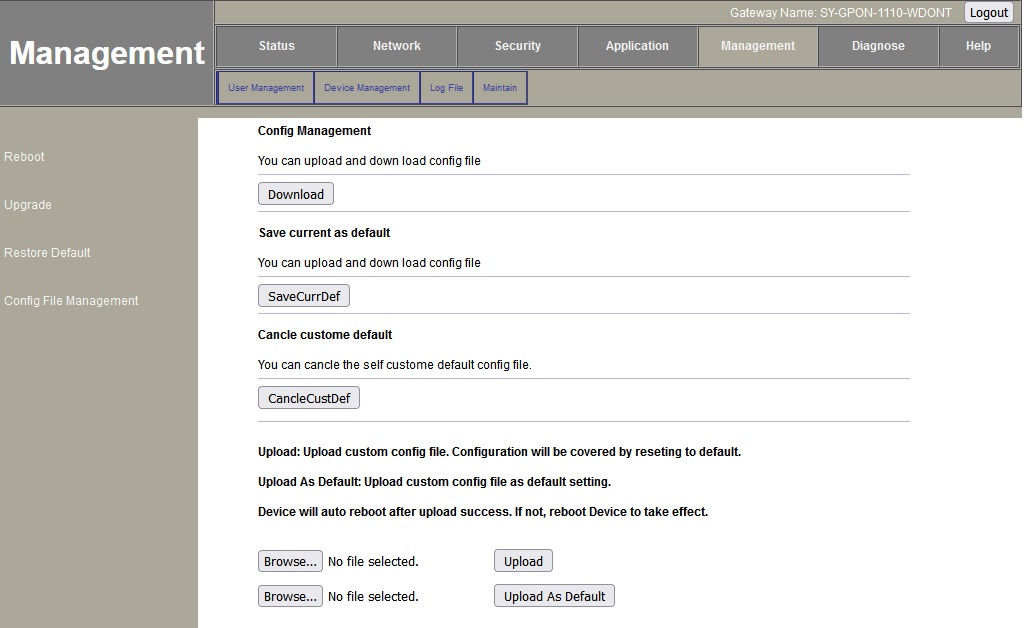

Backing Up Current Settings:
Q. 2 Before changing anything, How to safely backup All Settings in case I need to revert? Moreover, How to Restore this “LastGood.xml” file properly?
There are the following options under Device Management > Config File Management:
Save current as default
You can upload and download the config file <SaveCurrDef>
And
Cancel Custom Default
You can cancel the self-custom default config file. <CancleCustDev>
(There are typo errors on the Page, which is a bit unnerving)
Below the above options, it states:
Upload: Upload custom config file. Configuration will be covered by resetting to default.
Upload As Default: Upload custom config file as default setting.
The device will auto reboot after the upload success. If not, reboot the Device to take effect.
What do the abovementioned options do?

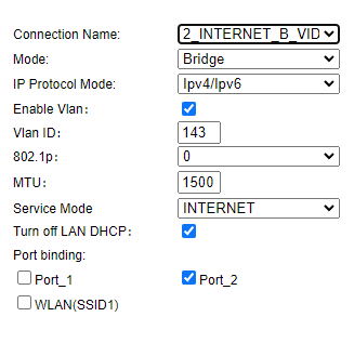

Choosing the “Bridge” Mode makes the PPoE Options Disappear, which is understandable. However, will Bridge Mode also make the VoIP options disappear/disable? I need to keep the Landline Active and Operational.
As evident from the screenshots, Port Binding is active on all Ports: Port_1, Port_2 as well as WLAN (SSD1).
Please advise HOW to correctly set up the Syrotech Combo device in Bridge Mode while keeping the landline alive and operational. I will configure the PPoE Credentials into the connected OpenWRT Router.

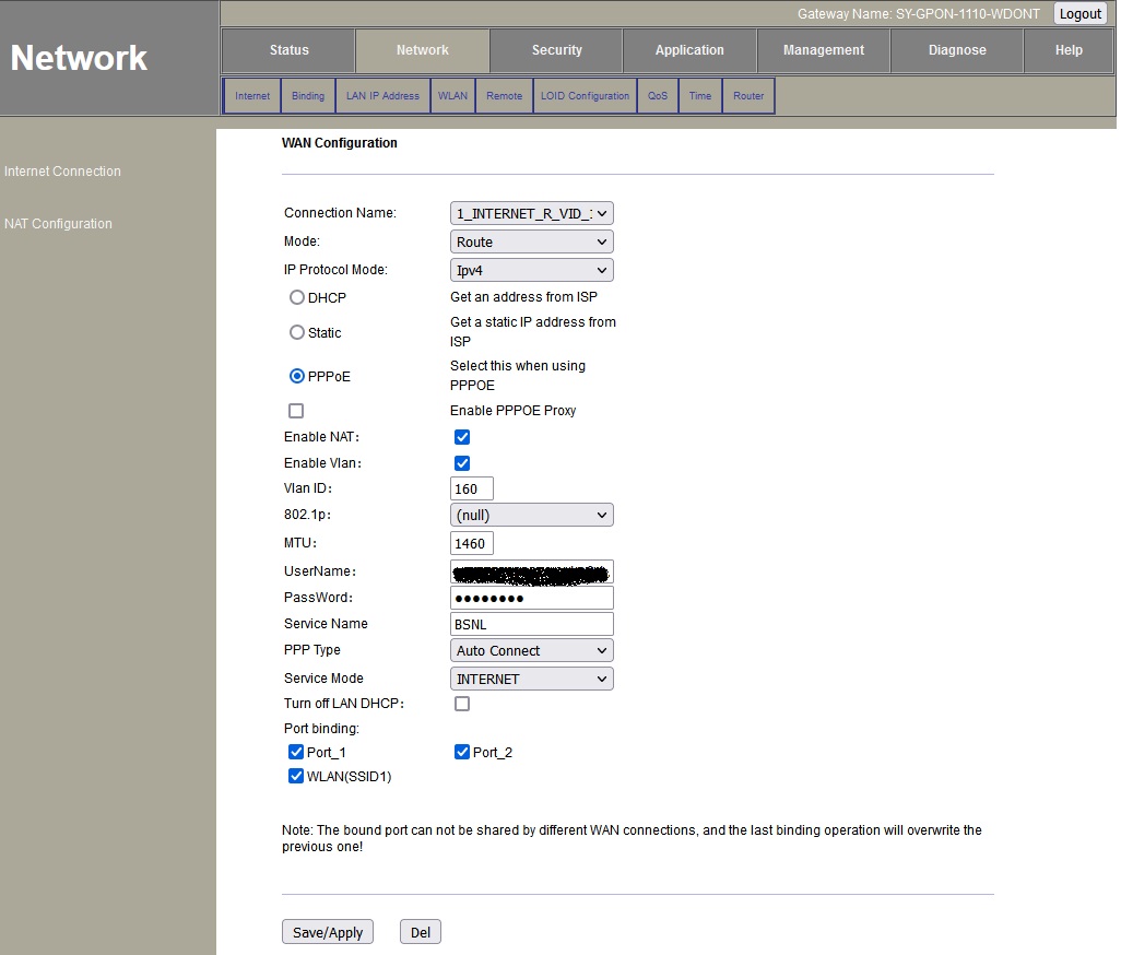

Are the following settings on the Syrotech Combo Device correct? Do they need to be changed?
  • Change Mode to Bridge Mode (from PPoE)
  • Select both IPV4/IPV6 on the IP Protocol Mode
  • Tick Enable VLAN and enter the VLAN ID provided by BSNL (160)
  • Select WHAT NUMBER (from null to 7) on 802.1p, and Why? Currently, it is set as (null)
  • MTU: 1460
  • Select INTERNET in Service Mode
  • Keep LAN DHCP Unchecked (Meaning, LAN DHCP will be Active?)
  • Port Binding - Select Port1 and Port2 and leave the WLAN (SSID1) Unchecked as WiFi is disabled.
  • NAT Type: NAT1 or NAT2 or NAT3 or NAT4 (Currently it is NAT4)

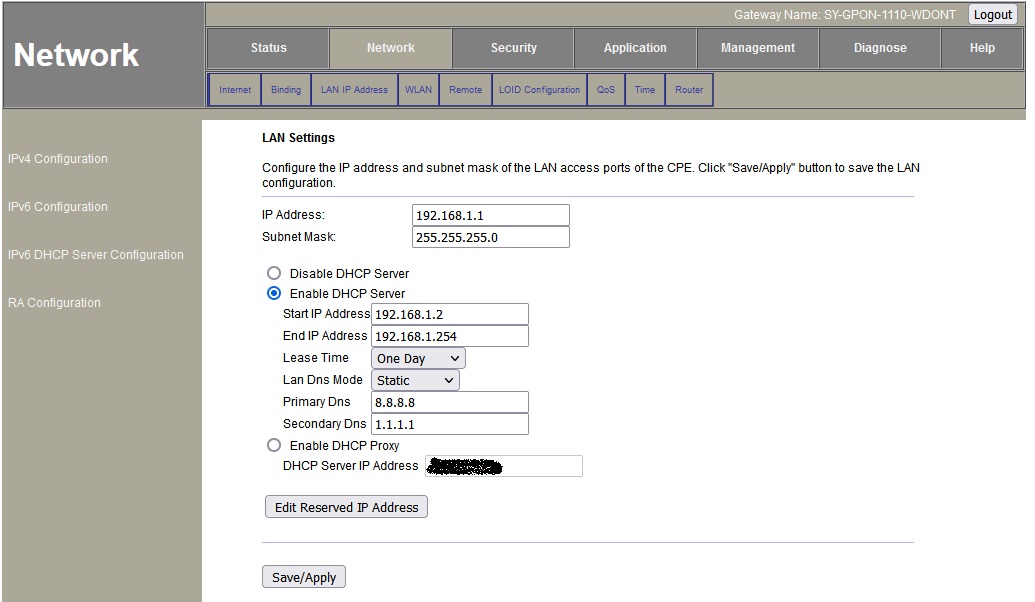

  • WHAT to enter in the LAN Settings Page: Disable or Enable DHCP Server?

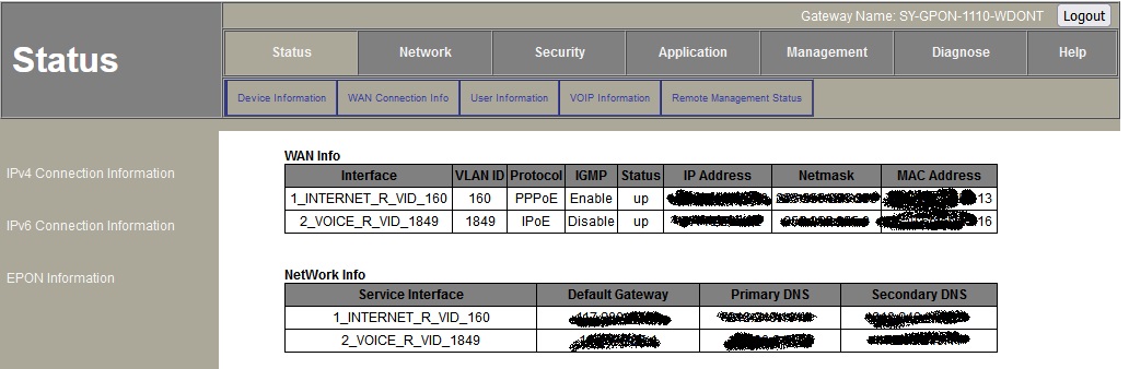

Override MAC Address - Customize MAC Address. Enter the WAN MAC address from the Syrotech Status Page from the 1_INTERNET_R_VID_160 row (not the PPPoE).
Registered, not authenticated means there is no authentication enabled on the OLT. You will still have to reset MAC for PPPoE or you can simply copy the one on the Internet profile under WAN Info.
Press Download and it will save the current config in an xml file. Use Upload instead of Upload as default to restore.
VOIP profile is separate from Internet profile.
For bridge mode, (Port 2 is gigabit and hence port bounded)

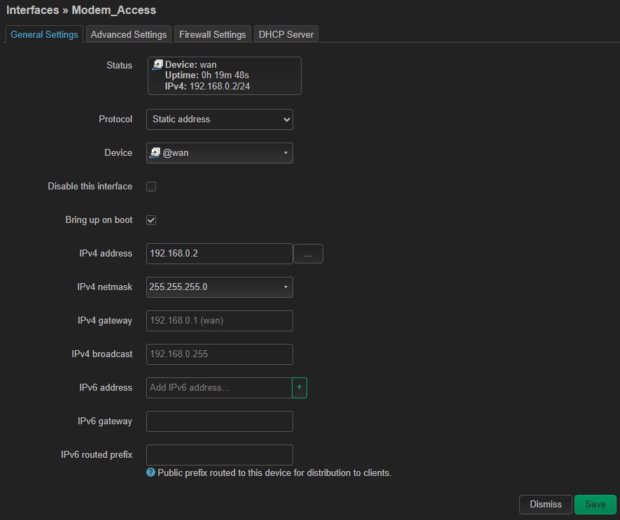

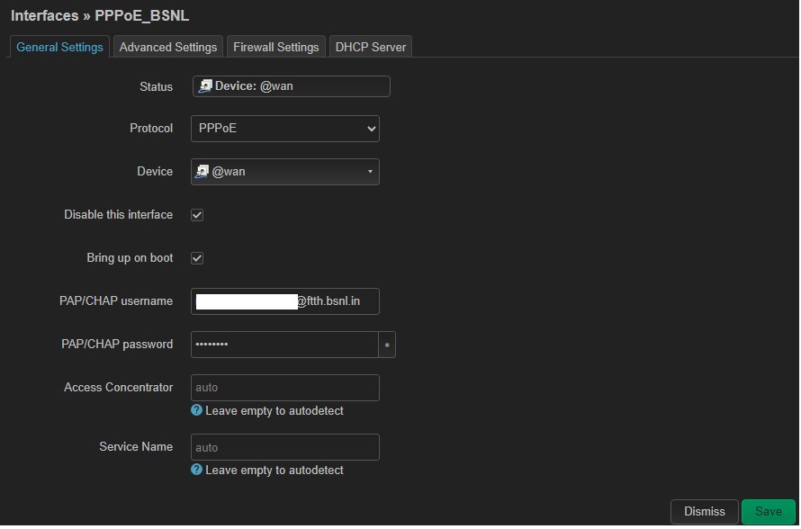

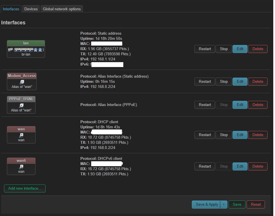

I have created a @Wan profile (PPPoE BSNL) and a Modem Access profile in Network > Interfaces.

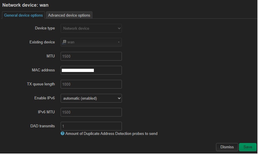

However, I am unable to change/override the MAC address.

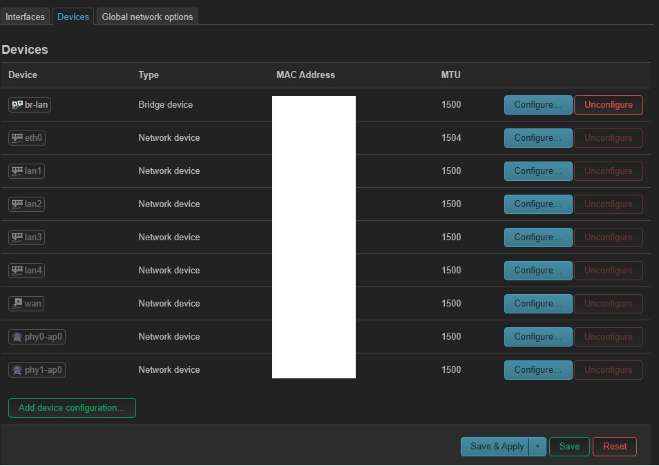

@sloj Here's the Devices Tab:
The Configure Option does not allow to change the MAC address as the field is Greyed out:
According to your previous advice for PPPoE handover to OpenWrt, I created a new interface select protocol (PPPoE), entered username (BSNL FTTH), password, and selected device (@wan). "Physical interface" is Device right?
What device is this? A mini PC or something else. I need to know the physical interface. br-lan contains which ones lan1-4, eth0 is what on the hardware, etc. Every device is different and layout is different for each device.
If I go with the first screenshot, then you need to delete alias of wan, wan and wan6, then configure wan and enter the cloned MAC from ONT PPPoE interface and save it. Then on interface tab create a new one, protocol PPPoE, device wan and the username, password. MAC shouldn't be greyed out, the default is displayed as a placeholder.

It is a Regular dual-band router with 4 LAN ports. There's a Single Gigabit WAN Port to which SY-GPON-1110-WDONT ONT is connected.
The router is running OpenWrt 23.05.
br-lan bridge device seems to be the 4 LAN ports.
I do not know what is eth0. But its MAC address is the same as that of br-lan, lan1, lan2, lan3, and lan4.
The phy1-ap0 and phy1-ap0 should be the WiFi Access points. They each have a separate MAC address.
The wan device too has its own MAC address.
