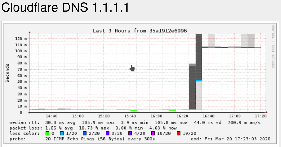

Code:
 Host                                    Loss%   Snt   Last   Avg  Best  Wrst StDev
1. _gateway                              0.0%    13    0.2   0.2   0.2   0.3   0.0
2. dhcp.tripleplay.in                    0.0%    13    2.2   2.7   1.3  13.4   3.3
3. wan-switch.static.tripleplay.in      23.1%    13    2.3   3.0   2.3   6.5   1.3
4. core-router.static.tripleplay.in      0.0%    12    1.7   1.7   1.3   2.2   0.3
5. nsg-static-073.92.72.182.airtel.in   25.0%    12  105.7 106.4 105.5 108.9   1.0
6. 116.119.49.159                       16.7%    12  113.0 107.2 105.5 113.0   2.4
7. 182.79.161.213                        0.0%    12  105.5  96.3  87.2 105.5   6.0
8. one.one.one.one                       0.0%    12  106.2 105.8 105.2 107.3   0.6
Specific to cloudflare. RIP
