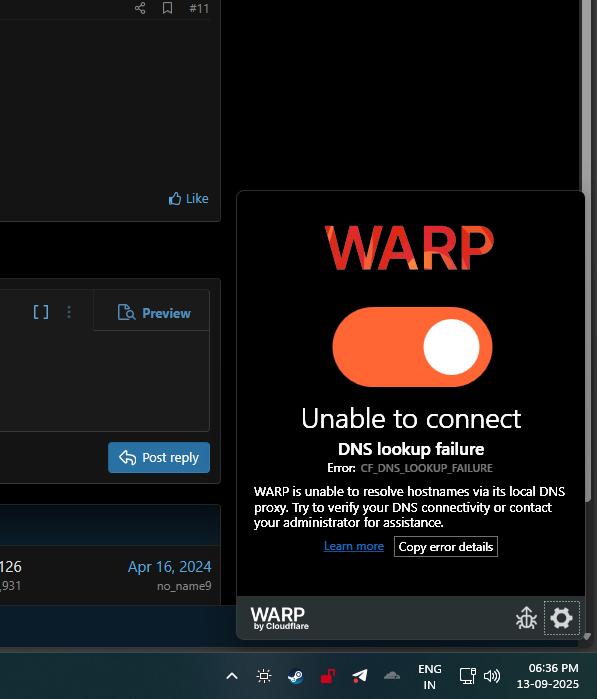

@Kyle Crane Ofcourse you have Goodbye DPI alternative on iOS
@akshay71 first impressions : this doesnt seem to work all that much
My Vi 4G sim is still loading things faster
And I’m trying out websites on incognito to be clear of any cache
I’ll keep checking if this does work later

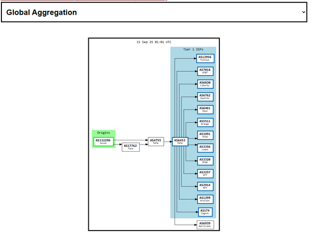

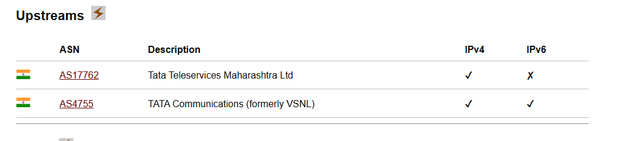

Does your ISP use Tata upstream by any chance?
I guess this means that my routing is through Tata? Also, I think due to heavy rains most of the dangling fibre cables are cut by falling trees and hence they have to switch to back up backhaul and that's what is causing this? (since it will take time to re lay those cables)
Hmm tata upstream seems to be the culprit here. There's nothing you can do ig. Just get a JioAirfiber as a backup and use booster packs for additional data, it's quite affordable, 250 for 500 GB data.
