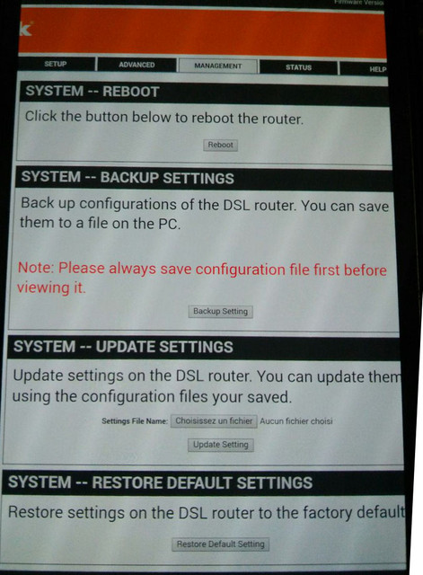

Does anyone know where the remote management option is in the router's settings? the setting page looks totally different to what it shows in the manual and there is Tool Tab.
