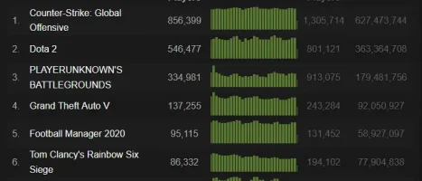

I am not a gamer anymore and hence I have this question -
Which are the most popular games right now.
