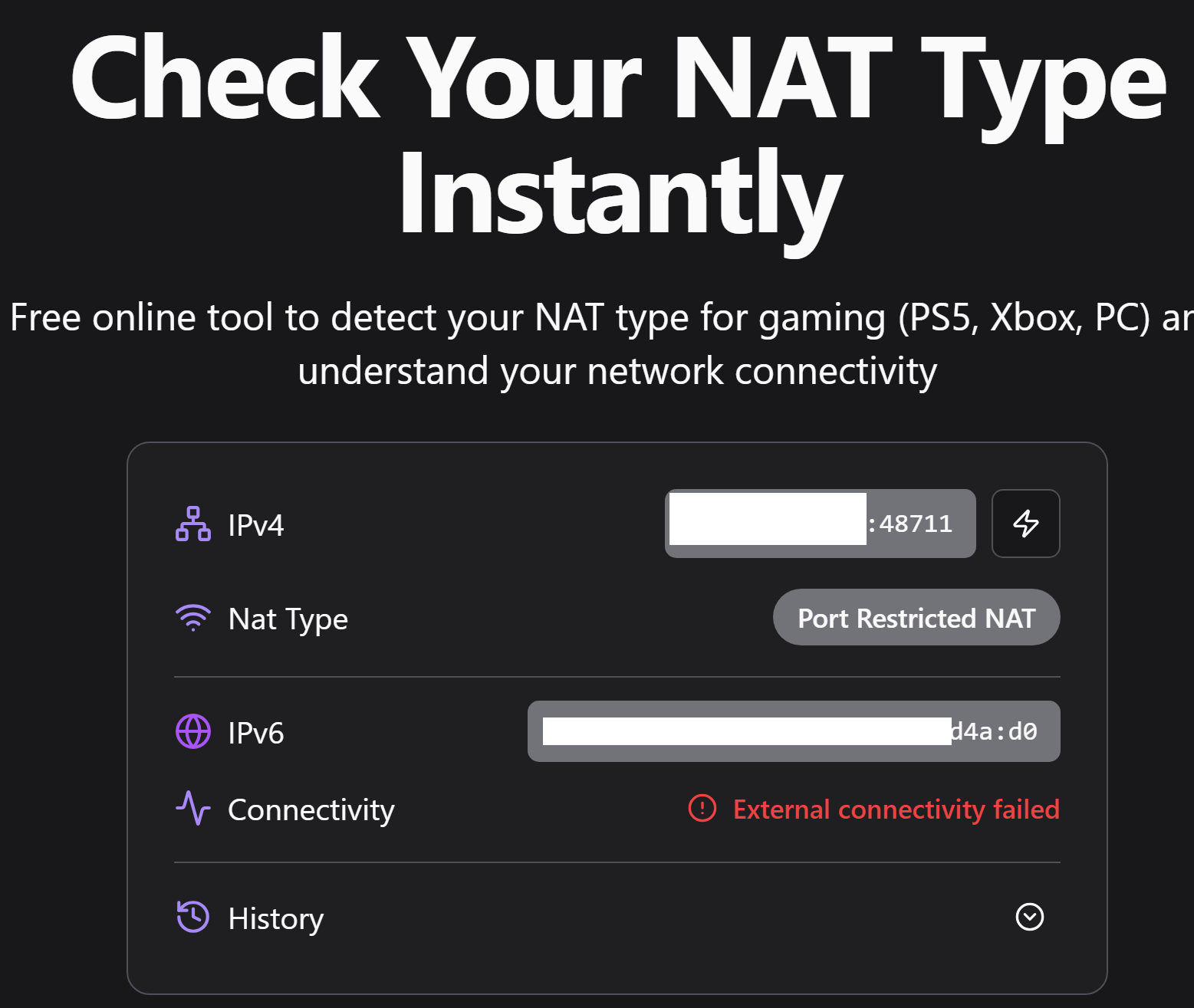

so when i check NAT type, i get the following result for ipv6, what does this mean?
That site you are checking from is total bs.
These online sites often have bad choice of words, as IPv6 has no concept of NAT mapping, they shouldn't even show IPv6 as a field and connectivity failed just indicates you have a working firewall.

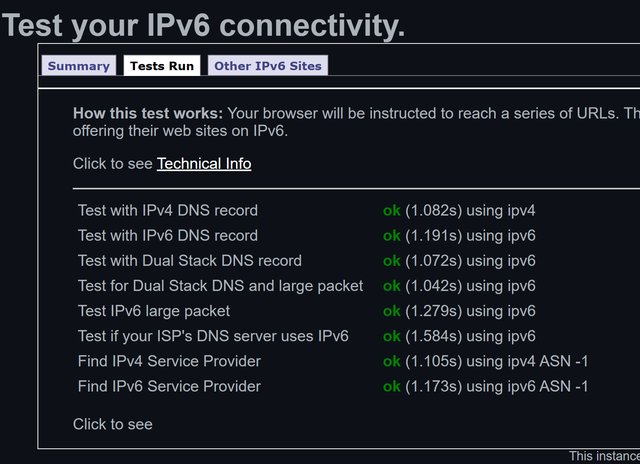

Use this stun/cmd/stun-nat-behaviour/README.md at main · pion/stun to know your IPv4 mapping and filtering behaviour.
To test IPv6 connectivity use this Test your IPv6.
i got a 10/10 readiness score with the above tests.

IPv6 connectivity is also fine.
