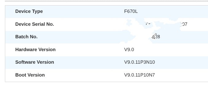

My ONU is unlocked so I'm using the latest Firmware -- V9.0.11P3N10. But this method should work on any current firmware.

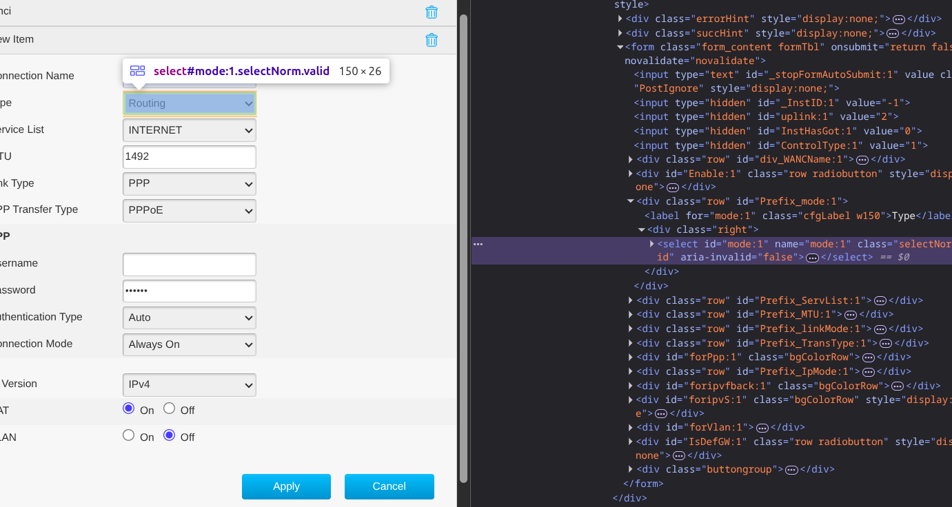

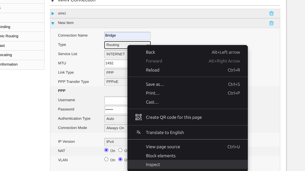

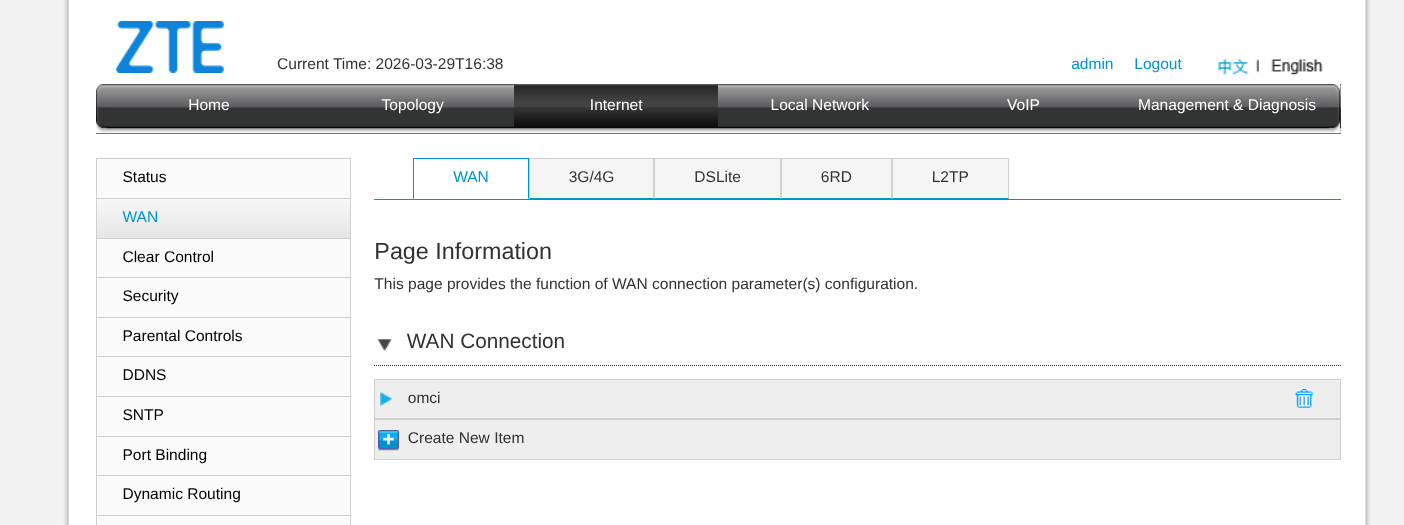

1. So the first step is to login and navigate to Internet>WAN>Create New Item

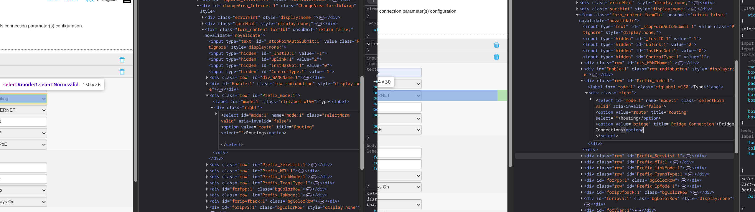

2. Give it any name -- Here I'm using 'Bridge', then Right click on the 'Type - Routing' and select Inspect
3. Now Right click on the highlighted line and select Edit as html
3. Now Carefully Paste the following line after </option> :
<option value='bridge' title='Bridge Connection'>Bridge Connection</option>
Click the empty space outside to save the changes.

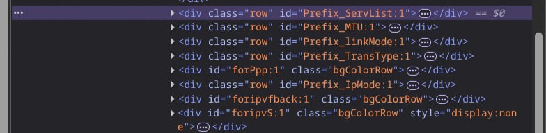

4. Now we have to delete the following 8 lines one by one:
Left click on the line and start pressing delete one by one

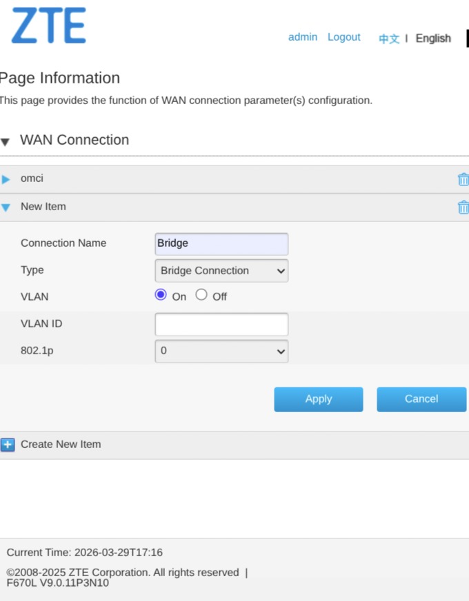

5. Now Change the Type to Bridge Connection, enable VLAN and add your VLAN id and click apply to save.

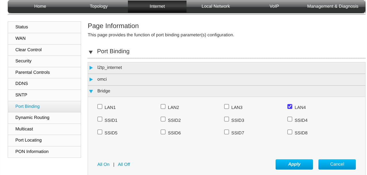

6. Now go to Port Binding and select whichever LAN port you want to use as the Bridge Port and apply to save the changes.

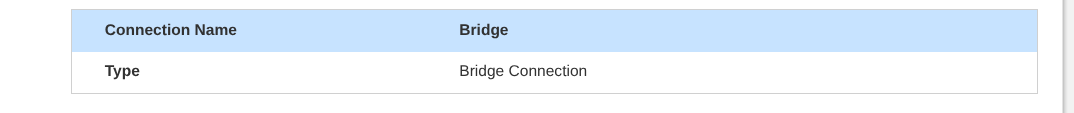

Now if you go to WAN status you can see your Bridge Connection there.
