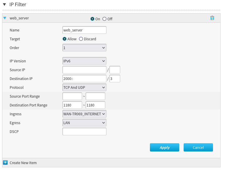

Right now this is the Ip filter -

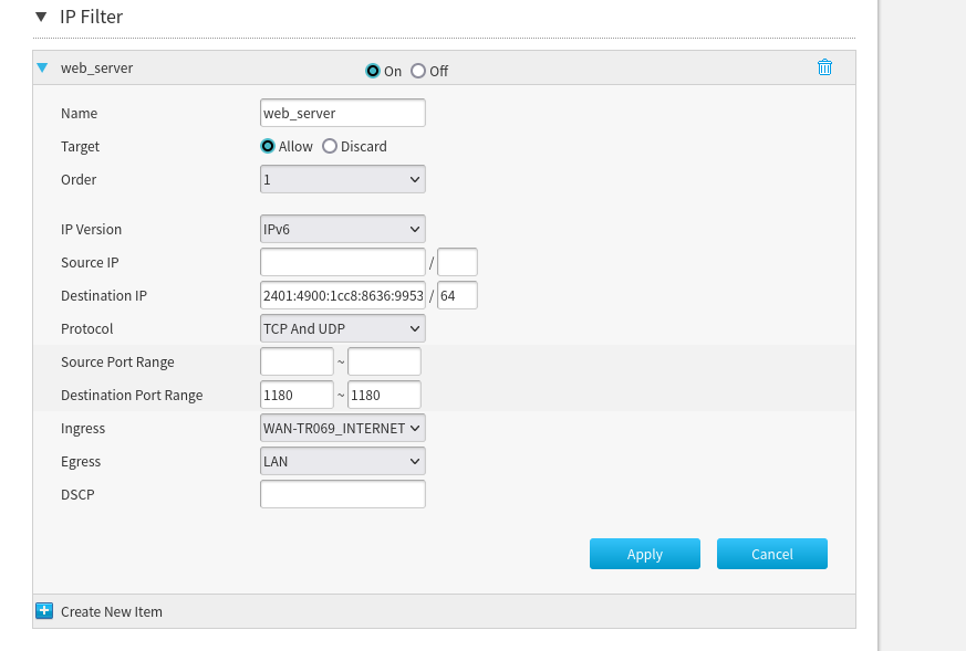

@panic0
Can you try specifying the exact address of the machine in firewall in the router? Maybe their implementation is idiotic and they do exact matches rather than looking it an address in the specified block
Upvote 0
