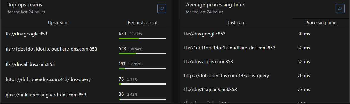

I run two instances of AdGuard Home with Google and OpenDNS as my upstream DNS server.
Slow DNS resolving disturbs me and my family members.
Am I facing this issue because of Airtel or something else.
tracert 1.1.1.1 and ping 1.1.1.1 shows me average speed of 3ms.

If they are just upstream to your own adguard instances it could just be an issue with the adguard setup?
May be. Adguard has been having issues with resolving speed. I am confused now. I'll try using pihole.
