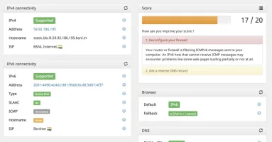

since last 3 days the ipv6-test.com website shows that icmp (v6) is not reachable. Earlier I used to get 19/20 , but now I get 17/20
All firewall settings are same as when the icmp (v6) was reachable.

The score is 17, cause the ICMP test is not being done or has failed. I am able to ping to my IPv6 address from elsewhere though. I wouldn't give much importance to that score as long as things are working,
Varkey , I used to get 19/20 and if I am in good mood to do reverse dns, used to get 20/20 on ipv6-test.com. However it seems that the website has issues with icmp pings so not showing correct results. However outside world can ping my ipv6 address.
Check it yourself... It will be live for a while 2402:3a80:65f:4400:4ef:6438:8850:5c8f
Try ping this... You will get ping but the ipv6-test website cant ping it...
