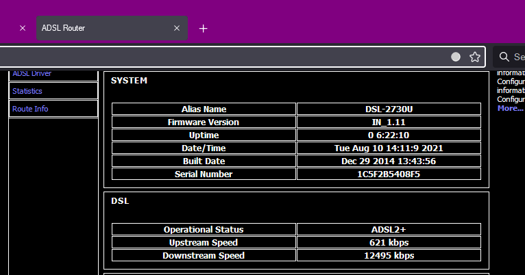

I thought of just postng some pictures , but power went off for an hour.
anyhow, please see my pic of router
My snr details and download details
Adsl Line Status SHOWTIME.L0
Adsl Mode ADSL2+
Channel Mode Interleave
Up Stream 621 kbps
Down Stream 12495 kbps
Attenuation Down Stream 29
Attenuation Up Stream 17
SNR Margin Down Stream 15.0
SNR Margin Up Stream 22.2
Vendor ID RETK
Firmware Version 4926e708
CRC Errors 235
Up Stream BER 0e-7
Down Stream BER 0e-7
Up Output Power 12
Down Output Power 19.5
ES 168
SES 0
UAS 0

@rajujayaraman The advertised speeds are possible only within 1km of telephone exchange. Maximum upto 1.5km but you will notice degradation. Remember this isn't line of sight distance but cable run length.
I saw the screenshots you posted. Signal levels have considerable attenuation. I'm unsure if this is a newly introduced phenomenon or if you used to always receive these speeds and have noticed it only now.
