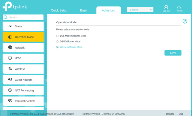

I think you should keep both routers gateway(IP) separate first and then try again and as mentioned here , first connect it to the laptop without the TP-Link router and as settings get in place , try connecting it
Maybe changing your TP-Link Operation mode to Router mode like this
Upvote 0
The Huawei is working fine since I am using it right now. But how would I connect the TP-Link to a fiber line? The tp-link was working great till the switchover to Huawei. When I connect it, it goes through POST and when it stabilizes, the internet light is still off and the others are working.
Upvote 0
The TP-Link is not recognizing a bridge connection as it picks up the PPPoE through the DSL port ( you are trying to bridge it on a LAN port) , so switch it to Router mode and then try . I have a feeling it will work
Upvote 0
LOL, still no go. I will keep trying. Right now I'm using my phone's hotspot since I've stopped Huawei from doing anything else but connect to the net.
I've switched TP-Link to Wireless Router Mode, thanks for this shashankb, it was not so before you told me.
