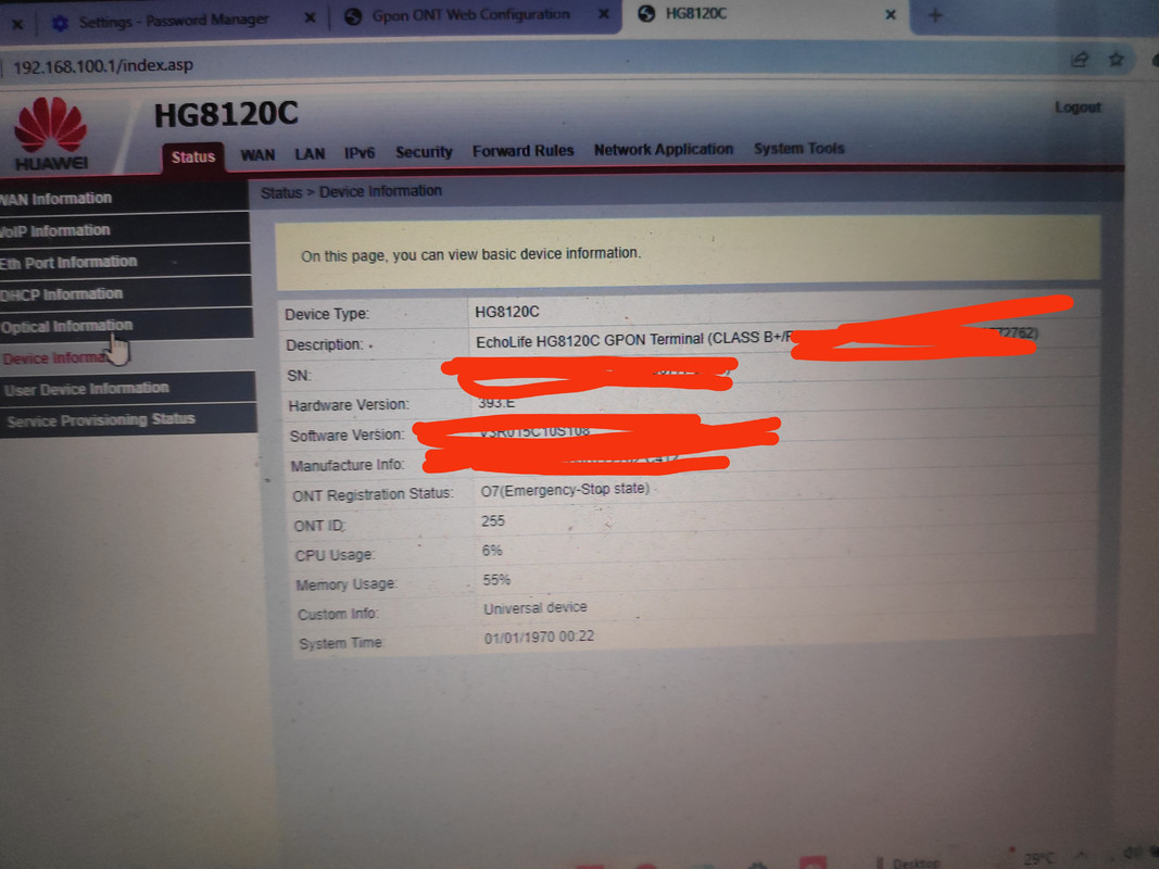

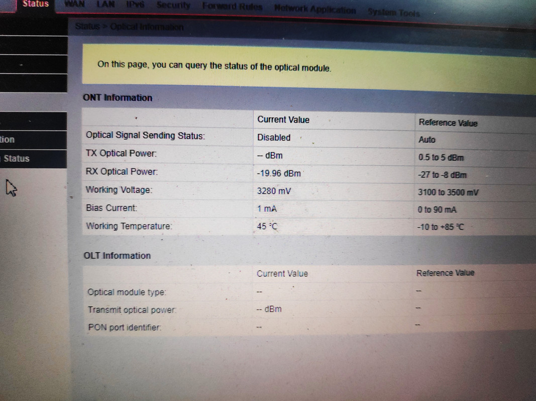

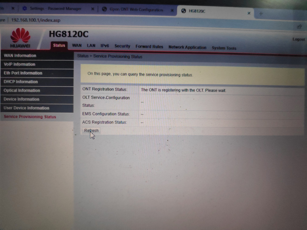

Recently took New BSNL connection and connected fiber to modem. No LOS light or PON light and when checked status of ONT, state is showing as O7(Emergency stop state). What may be the issue?
